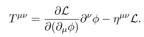

This is probably a stupid question but say I am in Minkowski s-t and I want to find ##T_{ii}##,
(Assuming signature ##(+,-,-,-)##), I get :
##(firstterm) + L = T^{ii}##
##T^{ii}## is a vector but ##L## is a scalar (obviously I appreciate for a more complicated metric the vector form will be apparent) but in this case it does not look right/ how should I think of it to understand it?
Thanks

I think you are starting with the expression $$T^{\mu\nu}=\frac{\partial\mathcal{L}}{\partial(\partial_\mu\phi)}\partial^\nu\phi-\eta^{\mu\nu}\mathcal{L}$$Then you are saying that at present you are only interested in the three spacelike on-diagonal components in an Einstein coordinate system, which are$$T^{ii}=\frac{\partial\mathcal{L}}{\partial(\partial_i\phi)}\partial^i\phi-\eta^{ii}\mathcal{L}$$where ##i=1,2,3## and no summation convention is assumed. Note that this is not a tensor expression. It is simply three expressions stating a relationship between ##\mathcal{L}##, ##\phi## and specific components of ##T##. That is, this is explicitly these three expressions:$$\begin{eqnarray*}
T^{11}&=&\frac{\partial\mathcal{L}}{\partial(\partial_1\phi)}\partial^1\phi-\eta^{11}\mathcal{L}\\
T^{22}&=&\frac{\partial\mathcal{L}}{\partial(\partial_2\phi)}\partial^2\phi-\eta^{22}\mathcal{L}\\
T^{33}&=&\frac{\partial\mathcal{L}}{\partial(\partial_3\phi)}\partial^3\phi-\eta^{33}\mathcal{L}
\end{eqnarray*}$$Because these are boring old differential equations, you may now substitute values for the components of ##\eta^{ij}##. You no longer expect the indices to match, any more than you do when you say something like ##\eta^{22}=-1##.
Your problem is that you substituted in some components of the metric, then expected the result not to be an expression about components.

but is it not true for #ii# general expression you get for the second term ##-L##. Why wouldn't one sub that in?
"Note that this is not a tensor expression. It is simply three expressions". That is like saying obtainin an expression for ##T_{i0}## is not a vector. Obviously it is the energy flux and so it is a vector?
It's only true in Einstein coordinates. You are picking those coordinates and then picking some of the components.

It has, several times. You have expressions for some components of a tensor. They do not function as tensor equations.
You understand that ##\eta^{22}=-1## is not a tensor expression, right? You just have a more algebraically complex version of this.

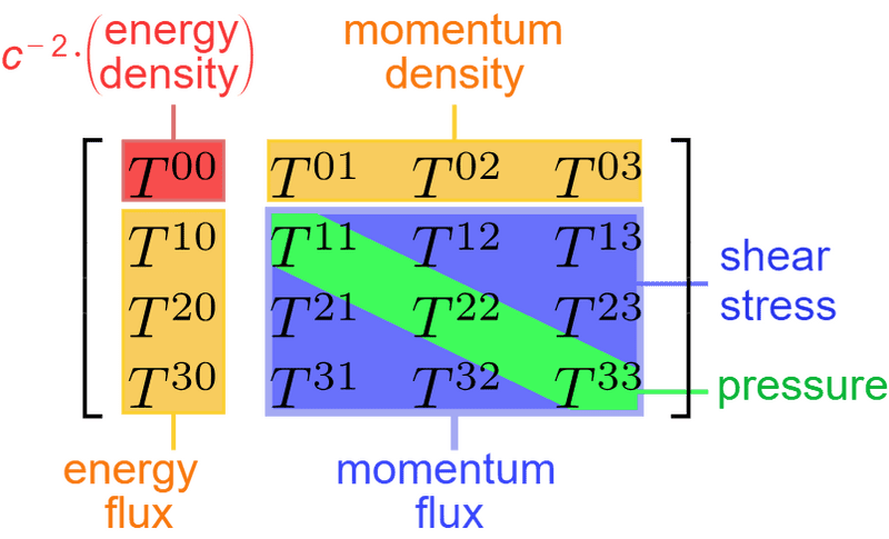

The energy flux expression is given by the above in some text. Why isn't this wrote as ##S^{\alpha}_0##? Because ##0## is a specified index right so not an index as such, but,
E.g when one refers to the components of the energy-momentum tensor as follows , one would write ##T^{i0}##, not ##T^i##.. this is kind of what I am getting at:
Because energy flux is a spatial 3-vector. It is forms a vector under the three-dimensional subgroup of rotations to the Lorentz group. In terms of the full Lorentz group you obviously have ##T^{i0}## but the particular choice of O(3) specifies a reat frame.

Because what is a pure rotation in one frame is a mix of rotation and boost in another. Or to put it another way, to pull out the spatial components of a four vector/tensor you have to have picked a definition of "space". Another frame will not pick out the same values.
