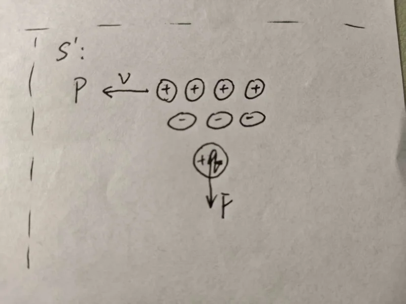

Exploring the relativistic origin of Lorentz force. I'm deriving how a transverse force (from length contraction) and a longitudinal force (from relativistic momentum compensation) combine to stay perpendicular to velocity.
I represent the conductor as two parallel lines: stationary protons and electrons moving at velocity ##v##. A test object with a positive charge also moves at velocity ##v## parallel to the electrons.
In frame ##S'## (the rest frame of the object), the object experiences a repulsive force (the origin of the Lorentz force) due to the length contraction of the moving proton line.

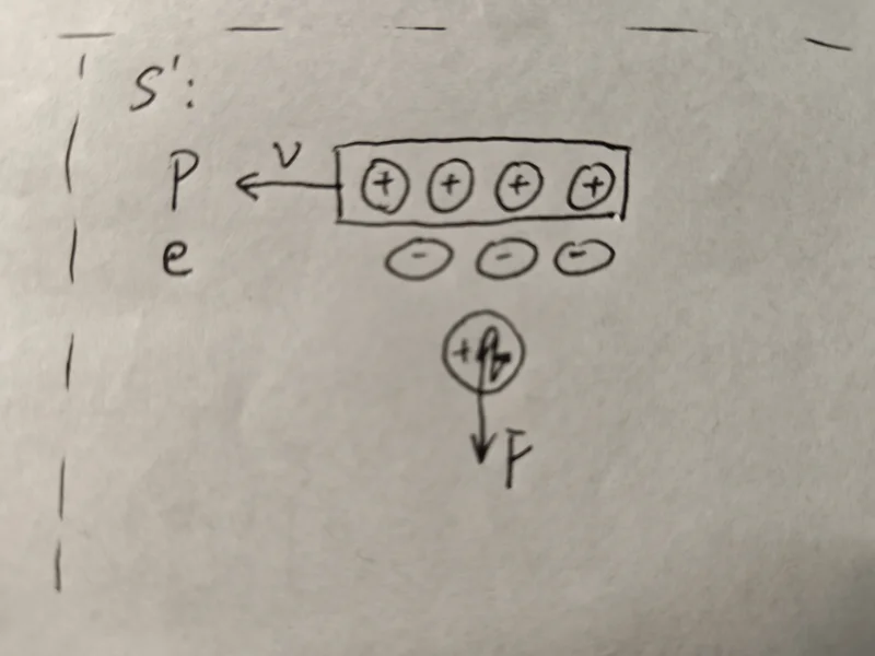

If I introduce an additional vertical velocity ##u## to the object in the frame ##S## the rest frame of the conductor), the entire conductor appears to move upward in frame ##S'##. Since length contraction only occurs in the direction of relative motion, this vertical shift seemingly shouldn't create any additional charge density imbalance, so there isn't any extra force.
Hand-drawn diagram in frame S': a row of four circled plus signs (protons) in a box, with an arrow labelled v pointing left, and a row of three circled minus signs (electrons) below. A circled plus sign beneath has a downward arrow labelled F.
Yet, someone told me that because of a kind of Transformation of Forces, the force in frame ##S## would be vertical, but WHT and HOW it transform?

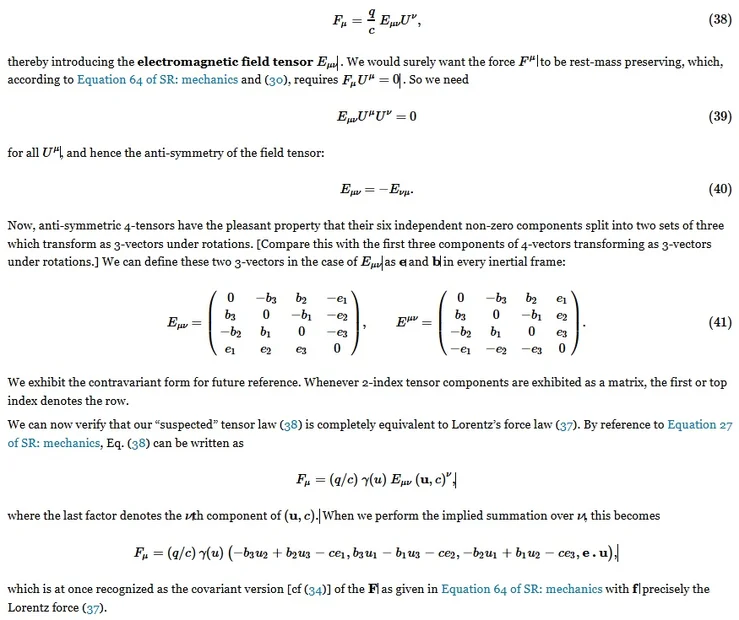

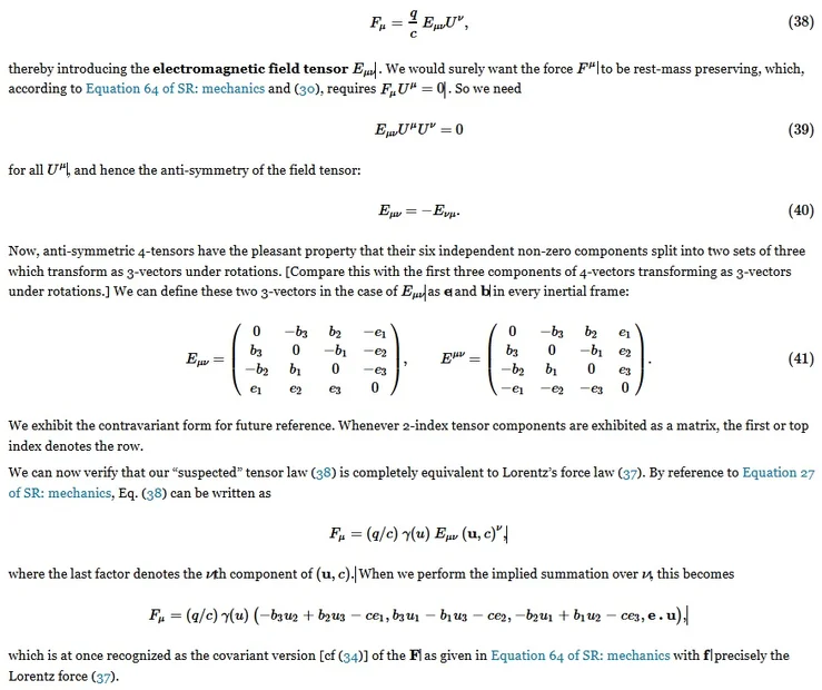

One could start from the equation for the Lorentz 4-force and from that it is rest mass-preserving.
Rendered page of equations (38) to (41) on the electromagnetic field tensor, showing F_mu = (q/c) E_mu,nu U^nu, anti-symmetry conditions, and 4x4 matrices for E_mu,nu and E^mu,nu with components e and b.
Source
Which is equivalent to what I wrote in post #4, i.e., it is not just the magnetic force. So what I said in post #4 would apply if one takes this approach.
Source
Your source got trimmed - but I do find the argument that the idea that the electromagnetic force should preserve the rest mass of a particle does imply that if we formulate the 4-force as a tensor, said tensor should be anitsymmetric. In terms of 4-forces and 4-vectors, it implies that the idea of preservation of rest mass requires that the 4-force should be orthogonal to the 4-velocity. This formulation of limitations on the form of the force law that make it preserve rest mass may be slightly more approachable as it requires 4-vectors rather than tensors. However, the original post was not written in a covariant framework, and I'm not sure how to translate this observation into a non-covariant form or how helpful it will be to the OP. We can hope it will be useful to them though.

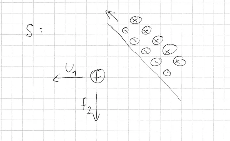

As I understand your scenario, the object is moving in frame ##S## not parallel and not perpendicular to the conductor. But the force must be perpenducular to the object's velocity, because in this frame there is only a magnetic field. It may look like this:
Hand-drawn sketch on grid paper labelled S: a row of circles with crosses on a diagonal line, with an arrow pointing up-left, and a positive charge circle moving left with velocity v1 and force f2 pointing downward.

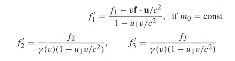

If you make a horizontal boost transformation to the rest frame of the object, then the force will be also vertically, accourding to the following force transformation formulas
(the indices ##1, 2, 3## correspondent to ##x, y, z##):
Force transformation equations: f1' = (f1 - v f·u/c^2)/(1 - u1 v/c^2) if m0 = const; f2' = f2/(γ(v)(1 - u1 v/c^2)); f3' = f3/(γ(v)(1 - u1 v/c^2)).
Source (page 124, equation 6.46):
https://www.amazon.com/Relativity-S...fgang-Rindler/dp/0198567324?tag=pfamazon01-20
shortened online version (equation 78)

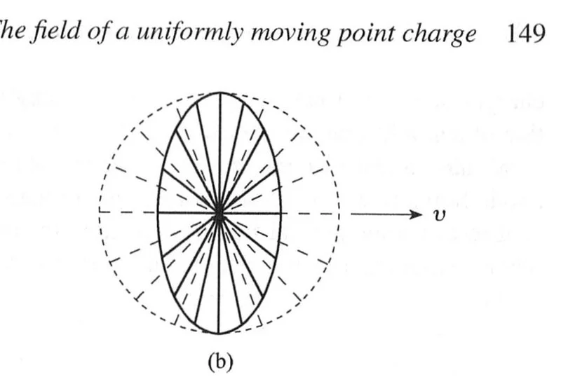

The fields of the moving positive atom-ions (and electrons) of the conductor in frame ##S'## are also length-contracted.
Diagram of an ellipse centred on a point charge, with radial lines from the centre drawn as solid and dashed, and a dashed circle around it; an arrow labelled v points right, showing the field of a uniformly moving charge.
