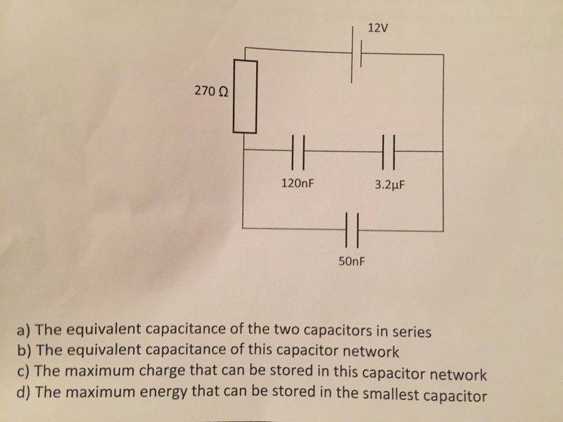

A circuit with a 12V battery then on the row below in series with the battery is a 120nF capacitor and a
3.2(mu)F capacitor then in parallel with those resistors is another resistor of 50nF. On the immediate left of the battery is a 270Ohm resistor.
First I am asked to calculate the equivalent capacitance of the two capacitors in series for which I did:
(1.2x10^-7) + (3.2x10^-6) = 3.32x10^-6 F
Next I was asked to work out the equivalent capacitance of this capacitor network
For which I did:
((1.2x10^-7)x(3.2x10^-6)) / ((1.2x10^-7)+(3.2x10^-6))= 1.16x10^-7
(1.16x10^-7) + (5x10^-8) = 1.66x10-7F
After this I was then asked to calculate the maximum charge that can be stored in this capacitor network for which i did:
(1.66x10-7)(12)=1.992x10^-6C
Then last but not least I was asked to calculate the maximum energy that could be stored in the smallest capacitor and I have no idea where to start.
Thank You

I think the only additional fact you need is the formula for the energy in a capacitor: [itex]E = \frac{1}{2} C V^2[/itex]

This is unclear. You are mentioning resistors that you haven't described yet. How does what you describe form a closed path ("circuit")? What does the resistor in parallel with the battery do? (Is it a resistor?).
Please upload a drawing of your circuit.

That is not correct. Series capacitors do not simply sum. Capacitors in parallel sum. Where is your Relevant Equations section of the required formatting template? You should have listed the equations required to combine capacitors in series and in parallel.

Is this okay? I have uploaded a photo of the problem
Yes, it's fine.
Now we can go through your answers:
That's not right. Note that capacitors in series do not combine by addition. How do they combine?
For which I did:
That looks fine. This time you combined the series capacitors correctly.
That looks fine.
Start by finding the steady-state charge or voltage on the smallest capacitor (that is, after some long time has passed after the circuit is connected and current has stopped flowing the capacitors reach their final charges or voltages).
What formulas do you know for determining the energy stored in a capacitor?
