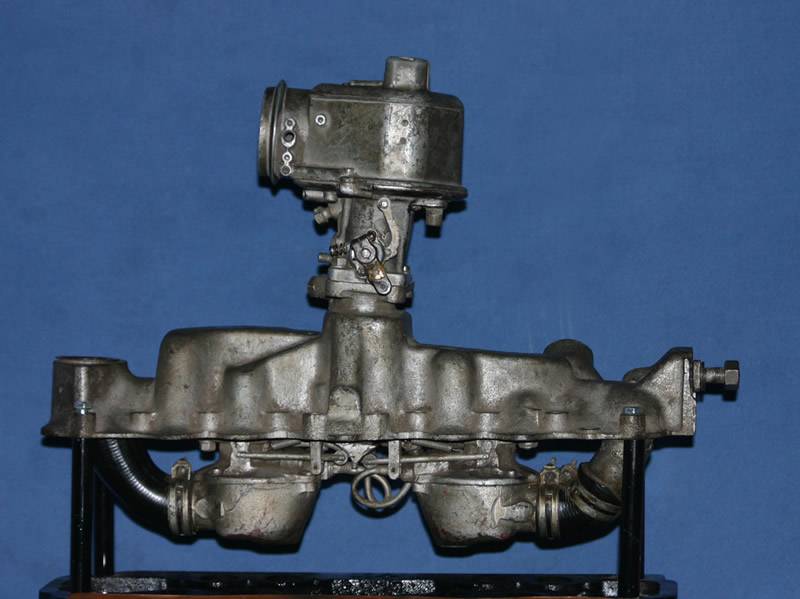

Some people are good at thinking outside the box, some people are good at keeping things as they are.
This is one of the think outside the box moments. Like hiding two carbs under the flat head Ford intake manifold in 1948.

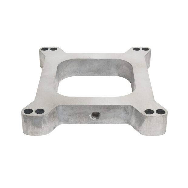

Your plenum is not large enough for your taste? You can increase it with a spacer:

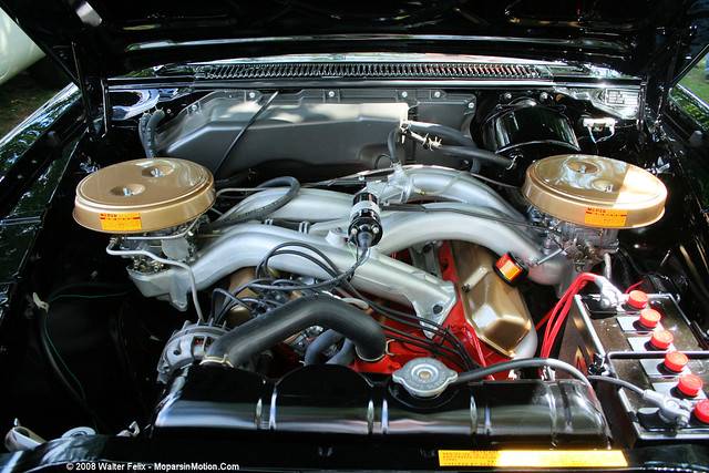

Love the Chrysler long ram manifold on the 413 cid B block, circa 1962
