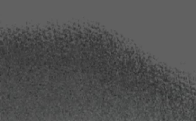

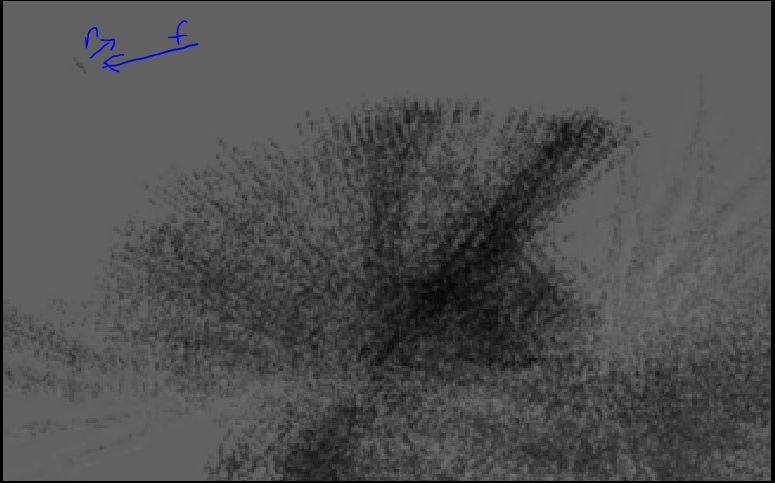

Also, the problem I was originally working on was trying to model a simple force f on a single point p. I was apply force via my computer's cursor or by other points in the scene and wanted either a plastic or elastic deformation to eventually result.
The screenshot above is from the renderer I'm building that shows an isolated point from other points in the scene.
The below screenshot shows many more points (millions) that form a continuous body.
I'll be studying and working on this for quite some time, but will try to remember to post back here if I figure it out.
Again, much appreciated
