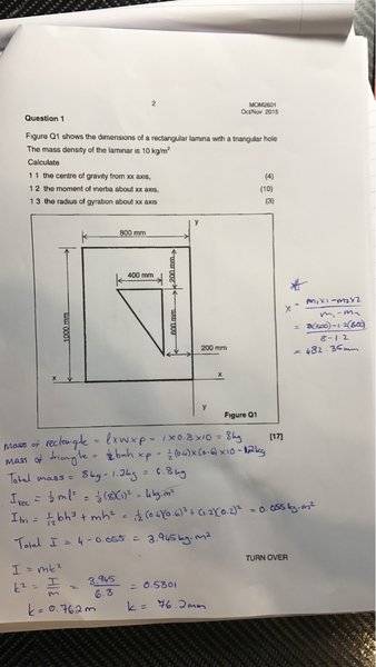

Centre of gravity: X=m1x1-m2x2/m1-m2
MOI rectangle: 1/3ml^2
MOI triangle: 1/18md^2
Radius of gyration: Ixx=mk^2
Mass of body 1: b*l*p = 0.8*1*10=8kg
Mass of body 2: 1/2b*h*p = 1/2(0.4)*0.6*10=1.2kg1.1
X=m1x1-m2x2/m1-m2
= 8*(-400)-1.2*(-1000/3)/8-1.2
= -411.7mm
1.2
Ixx= 1/3ml^2 - 1/18md^2
= 1/3*8*1^2 - 1/18*1.2*0.2^2
=2.664m^4
1.3
Ixx=mk^2
2.664=(8-1.2)*k^2
k=625.91mm

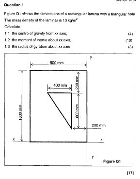

How do you get 400, why -400, and how do you get 1000/3?
That should be 500, from the centre of the rectangle to the XX axis is 500mm.
I believe the centre of the triangle should be 2/3*600 = 400mm
Then added to the 200mm from the start of the triangle to the XX axis should give 400+200=600mm.
I put a negative in front of the 400 and 1000/3 as they are "away" from the XX axis.
I don't know why I put 1000/3, I think I was dividing the length of the rectangle in 3 because of the triangle for some reason.
X=m1x1-m2x2/m1-m2
= 8*(-500)-1.2*(-600)/8-1.2
= -482.35mm
Right.
But they are "away" from that axis in the positive y direction.
haruspex said:
Right.
Meaning they should be positive?
If they were below the X axis then they would be negative? In other words if the XX axis were at the top of the rectangle.
Yes.
Okay so then
X=m1x1-m2x2/m1-m2
= 8*(500)-1.2*(600)/8-1.2
= 482.35mm
Is this correct?
What about my answers for 1.2 and 1.3?
The term for the triangle is wrong. What axis would be right for that expression?
The formulae given for a rectangular triangle:
about aa axis
I=1/18md^2
about bb axis (through G)
I=1/18mh^2
because we want the inertia about xx axis I used =1/18md^2 where d=distance to xx axis=200mm
DevonZA said:
about aa axis
I=1/18md^2
I don't know what you mean by aa axis here, but that expression is for the moment of inertia about an axis through the centroid and parallel to one side. d is the width orthogonal to the axis. So here, d=0.6 for an axis through the centroid and parallel to the x axis.
To get from that axis to the xx axis itself you need to use the parallel axis theorem.
