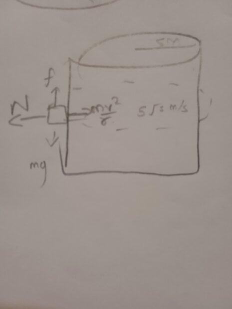

A motorcyclist wants to drive on the vertical surface of a wooden well of radius 5m. In horizontal plane with speed of 5 root 5 m/s. find the min value of coefficient of friction between tyres and the wall of the well
Ah

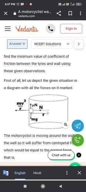

So far: I an having trouble in the FBD. I drew one completely opposite to one I found on google . in this image NORmal force is pointed away from the cyclist and centripetal force is pointed away from the centre . mine was the complete opposite am i wrong?

As far as I know normal force acts away from the body when two bodies are pressed as some sort of repulsion. Therefore the normal force on the cyclist from the well should also be away from the body? Also why is centrifugal force coming into play?

So this is correct?
Sorry I am new here im not sure if you replied to my post or to @BvU 's reply.
tellmesomething said:
So this is correct?
Yes, the normal force on the cycle is also equal to the net force, which is the mass times the centripetal acceleration.
The normal force comes from contact with the wall, so points towards the centre, as in the diagram. Whether it is shown as from the cyclist towards the centre or from the wall towards the cyclist is irrelevant.
The problem is that the text says "centripetal" but the diagram is for centrifugal.
The centripetal force would not be shown in an FBD because it is not an applied force; it is just a component of the resultant of all the applied forces.
In this case the normal force supplies the centripetal force: ##\vec N=\vec F_{centripetal}=-\frac{mv^2\hat r}r##. That's in an inertial frame.
In the frame of reference of the cyclist, there is no acceleration. The centrifugal force is effectively an applied force, so would be in the FBD. It balances a component of the net of all the other forces, namely, the component normal to the velocity: ##\vec N=-\vec F_{centrifugal}=-\frac{mv^2\hat r}r##.
A free body diagram should show the forces acting on one body. I think your googled drawing shows more, leading to confusion.
is definitely NOT correct. Such a force would not act on the cylist,

I dont understand why centrifugal force comes into play here, isn't the cyclist moving in that circle because there's a force pulling it towards the centre, which should be centripetal?
