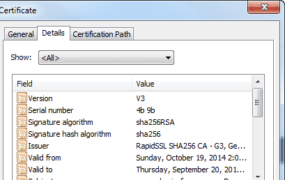

Chrome is giving the following warning:
The identity of this website has been verified by RapidSSL CA but it does not have public audit records.
The site is using outdated security settings that may prevent future versions of Chrome from being able to safely access it.
How is that message being presented? I am using the latest Chrome and only see that text if I click the lock in the address bar and go to the connection tab.
The triangle warning sign comes up on the lock in the address bar, and if I click on it to see what the problem is, I see that message.
I'm using the dev level of Chrome, which seems to have recently updated itself: 40.0.2188.2 dev-m

I don't see any problem in Firefox, Opera or Safari. I think I saw some recent news item that said someone had recently demonstrated that it was possible to fake a certificate chain and that something was being tightened up in Chrome to prevent that, so it might be something to do with that. Apart from that, it could of course be a Chrome bug. I use the dev version on my personal laptop to try to get some advance warning of what they will break next in the stable version!
Likes Greg Bernhardt
I've found the description of the change in the Chrome issues: https://code.google.com/p/chromium/issues/detail?id=401365
The title is "Deprecate SHA-1 for certificates".
I haven't fully understood it, but I think they are trying to move people off SHA-1 signing of certificates because it has been demonstrated that it can be faked, and that matches the recent news item.

It's definitely a move by Google with Chrome. I received notices from Symantec for my sites at the beginning of September:
"We would like to inform you of Google's intent to phase out support for certificates using a SHA-1 hashing algorithm via degraded visual indicators and warnings in the Chrome™ browser. These changes are expected to take effect in the production version of Chrome version 39 in November 2014."
Acquiring the SSH-2 update certificates from Symantec was easy. Plan to install at Hostgator next week.

I'm updating to SHA-2. There may be some certificate warnings while I'm doing this.
Lookin' good, Greg!
Greg Bernhardt said:
@Jonathan Scott do you still get the warning? The connection should be SHA-2 now.
Warning triangle has gone, thanks.
