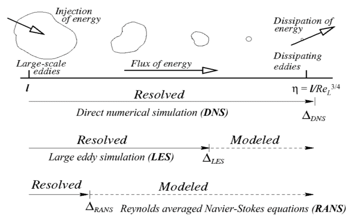

In a turbulent flow, there are many scales, as you have pointed out, and generally, the difference in scales between the largest and the smallest scales is many orders of magnitude. With a DNS, if your grid does not resolve down to the smallest scales of physical importance (which typically range from nanometers to micrometers), then you are effectively averaging out or ignoring part of the physics. If you don't resolve the largest scales (often measured in meters), then you do the same thing, only the situation is worse because those contain most of the energy. Furthermore, as ##Re## increases, the separation in scales becomes greater and the time separation required in stepping the solution decreases. So the problem essentially boils down to the number of grid points and time points that you need in order to resolve all of the relevant scales. As it turns out, the number of operations required to solve such a problem on a computer scales as ##Re^3##, so it rapidly approaches a point where even modern supercomputers take an impractical length of time to solve a problem.

Thank you for your explanation. I found the following graphic which also helps.
