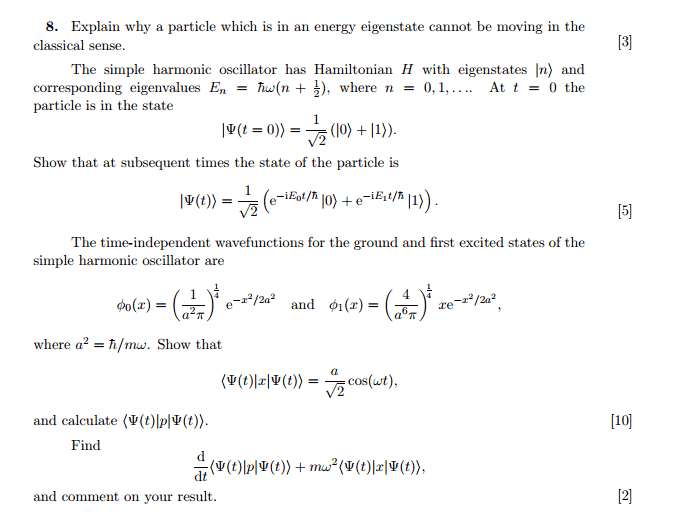

A state at time t is given by:
[tex]|\psi\rangle = \frac{1}{\sqrt 2}\left[ e^{-\frac{i\omega t}{2}}|0\rangle + e^{-i\frac{3\omega t}{2}}|1\rangle \right][/tex]
Where eigenfunctions are ##\phi_0 = \left(\frac{1}{a^2 \pi}\right)^{\frac{1}{4}}e^{-\frac{x^2}{2a^2}}## and ##\phi_1 = \left(\frac{4}{a^6 \pi}\right)^{\frac{1}{4}} x \space e^{-\frac{x^2}{2a^2}}##.I'm supposed to find ##\langle \psi|\hat p|\psi \rangle##.
[tex]\hat p = -i\hbar \frac{\partial}{\partial x}[/tex]
By symmetry, we know that ##\langle 0|\hat p|0 \rangle = \langle 1 | \hat p | 1 \rangle = 0##.
Starting:
[tex]\frac{1}{2} \langle 0 | e^{-i\omega t} \hat p |1\rangle[/tex]
[tex]= -\frac{1}{2}i\hbar \left(\frac{4}{a^8 \pi^2}\right)^{\frac{1}{4}}e^{-i\omega t} \int_{-\infty}^{\infty} e^{-\frac{x^2}{2a^2}} \frac{\partial}{\partial x} \left(x e^{-\frac{x}{2a^2}}\right) dx[/tex]
[tex]= -\frac{1}{2}i\hbar \left(\frac{4}{a^8 \pi^2}\right)^{\frac{1}{4}}e^{-i\omega t} \int_{-\infty}^{\infty} e^{-\frac{x^2}{2a^2}}\left(e^{-\frac{x^2}{2a^2}} - \frac{x^2}{a^2} e^{-\frac{x^2}{2a^2}}\right) dx[/tex]
[tex]= -\frac{1}{2}i\hbar \left(\frac{4}{a^8 \pi^2}\right)^{\frac{1}{4}}e^{-i\omega t} \int_{-\infty}^{\infty} e^{-\frac{x^2}{a^2}} \left(1 - \frac{x^2}{a^2}\right) dx[/tex]
[tex]= -\frac{1}{2}i\hbar \left(\frac{4}{a^8 \pi^2}\right)^{\frac{1}{4}}e^{-i\omega t} \left[ \sqrt \pi a - \frac{1}{a^2} \frac{1}{2} \sqrt {\pi} a^3 \right][/tex]
[tex]= -\frac{i\hbar}{2} \left(\frac{4}{a^8 \pi^2}\right)^{\frac{1}{4}} \left(\frac{1}{2} \sqrt \pi a \right) e^{-i\omega t}[/tex]
[tex]= -\frac{i\hbar}{2\sqrt 2 a} e^{-i\omega t}[/tex]
Similarly, for ##\frac{1}{2}\langle 1 | e^{i\omega t} \hat p | 0 \rangle##, we take the complex conjugate of above.
Adding them both together, we get:
[tex]-\frac{\hbar}{\sqrt 2 a} sin (\omega t)[/tex]
Given ## \langle \psi |x|\psi\rangle = \frac{a}{\sqrt 2} cos (\omega t) ##, then I'm supposed to find:
[tex]\frac{\partial}{\partial t} \left( \langle \psi|p|\psi\rangle + m\omega^2 \langle \psi |x|\psi\rangle \right)[/tex]
They don't add up to zero, which is strange since the first term is simply the force, and the second term is the restoring force..
Isn't there a dimensional problem here? Momentum has dimensions ##MLT^{-1}## and ##\omega## has dimensions ##T^{-1}##.
So ##m\omega^2 x## has dimensions ##MLT^{-2}##.
If I got that right, then you can't add ##p## and ##m\omega^2 x##.
(In this problem, ##a## must have dimensions ##L## for consistency, so that seems consistent with the expectation values you found.)

Here is the full question:
I'm trying to find the link between finding ##\langle x \rangle##, ##\langle p\rangle## and the last part of the question.

My problem is that they don't sum to zero, as forces should balance.
[tex]\frac{d\langle p \rangle}{dt} = -\frac{\hbar \omega}{\sqrt 2 a} cos (\omega t)[/tex]
[tex]m\omega^2 \frac{d \langle x \rangle }{dt} = -\frac{ma\omega^3}{\sqrt 2} sin (\omega t)[/tex]
They are wildly different.

But even still, they don't sum to zero:
[tex]m\omega^2 \langle \psi |x|\psi\rangle = \frac{ma\omega^2}{\sqrt 2} cos (\omega t)[/tex]
Almost there! Now use the definition of [itex]a[/itex] given in the question.
##a## is a constant, it's not defined in the question.
Unscientific, your second long equation is not correct. Try the differentiation again. : )

Look about 2/3 of the way through the question, right after the wavefunctions. It's the characteristic length scale of the harmonic oscillator, for what it's worth.
Oxvillian said:
:cry:
I can't believe I missed that out! Thanks so much for your help! That looks right now.
