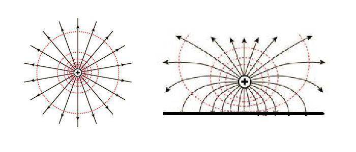

First, you can choose the zero of the potential at any place. The potential is defined by an additive constant. For a point charge, it is convenient to choose the potential tending to zero at infinity. In that case, it is kQ/r at distance r.
When ground is involved in a problem you might bring "infinity", the zero of potential, close to the charges. But the electric field becomes different from that when the zero of the potential is far away, at infinity. See picture. In case of the left one, the potential is zero at infinity. For the right one, the potential is zero at the ground and also at infinity.
And there are problems when the potential is not defined with respect to infinity. In case of infinite charged plate or infinite long charged wire.
ehild
