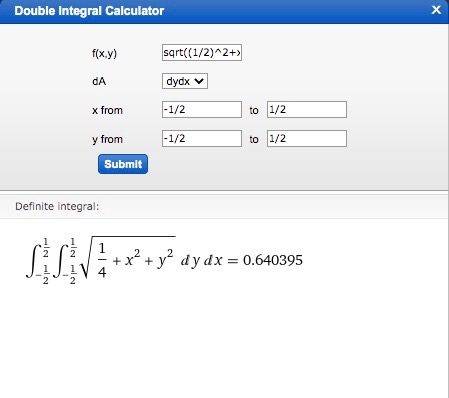

Also, it would be interesting to do a capacitance measurement of a 1 cm cube vs. a similar sphere at some DC voltage. Since it would not by a typical 2 pole capacitor, any suggestions as how to do it? My initial guess would be to hook the negative terminal of a battery to the electrically isolated cube or sphere and the other terminal to ground. Would the capacitance be measured en between the cube or sphere and ground? Fluke digital multimeters have a capacitance setting and I was thinking of using that.
Correcting an earlier error I made, the average distance from the center to an edge of a unit cube is actually 0.640395!
This suggests ##C≈4 \pi \epsilon_0 (0.6404) a## where ##a## is the cube length.
