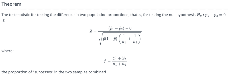

Comparing proportions does not use the same test statistic as comparing means. See this.

I am not an expert in this, but IMO, this does not use the correct standard deviation in the denominator for proportions. But it appears that they are expecting you to use this. I wouldn't get too concerned about it as long as you are learning the basics of the lesson. Just realize that a proportion is different and you can always look it up if you are using it in a critical application.
Agent Smith said:
I get a p-value from the z score and then can use that to reject/fail to reject ##H_0##.
Yes.
And the correct standard deviation would be ? 🤔
See post #8. It's the denominator of the formula for ##z##.

Your post #5 specifies that you are testing proportions. You need to be careful that you are using the correct statistic for proportions. I see that the reference I posted is for both proportions being estimated from the samples. I do not know the correct formula if one of the proportions is known, as this problem states, rather than estimated.

Here is a reference for the correct test statistic to use when comparing a known proportion to a sample proportion. The denominator for ##Z## has an additional factor of ##1-p_0##. That makes sense since the test should have symmetry between ##p_0## and ##1-p_0## (ie, the test for the proportion having the property of interest should give the same result as the test for the proportion not having the property)
(I will leave it at that, since I am not expert in this. I have to defer to the Pen State reference.)
That is correct. It slipped my mind. Sorry for the undue delay.
