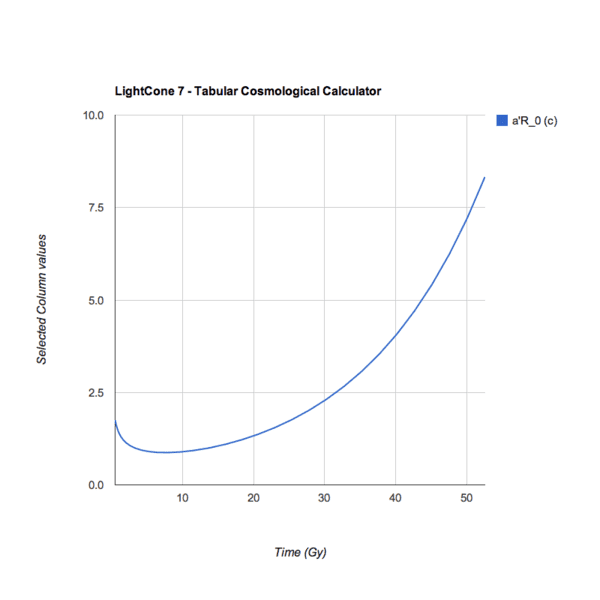

I wanted a plot including some future, so I could show real acceleration, so I changed the S range to be from 10 to 0.1, not so far back into the past. This goes from year 545 million out to around 52 billion.
You can see acceleration kicks in sometime between year 7 billion and year 8 billion. Here are the numbers:
[tex]{\scriptsize\begin{array}{|r|r|r|r|r|r|r|r|r|r|r|r|r|r|r|r|} \hline a=1/S&S&T (Gy)&a'R_{0} (c) \\ \hline 0.100&10.000&0.545&1.757\\ \hline 0.117&8.577&0.687&1.628\\ \hline 0.136&7.356&0.865&1.509\\ \hline 0.158&6.310&1.089&1.399\\ \hline 0.185&5.412&1.370&1.299\\ \hline 0.215&4.642&1.723&1.208\\ \hline 0.251&3.981&2.165&1.126\\ \hline 0.293&3.415&2.716&1.053\\ \hline 0.341&2.929&3.403&0.990\\ \hline 0.398&2.512&4.250&0.939\\ \hline 0.464&2.154&5.286&0.901\\ \hline 0.541&1.848&6.536&0.878\\ \hline 0.631&1.585&8.015&0.873\\ \hline 0.736&1.359&9.728&0.890\\ \hline 0.858&1.166&11.661&0.932\\ \hline 1.000&1.000&13.787&1.000\\ \hline 1.166&0.858&16.069&1.098\\ \hline 1.346&0.743&18.307&1.218\\ \hline 1.553&0.644&20.621&1.367\\ \hline 1.792&0.558&22.988&1.548\\ \hline 2.068&0.484&25.392&1.764\\ \hline 2.387&0.419&27.822&2.019\\ \hline 2.754&0.363&30.269&2.317\\ \hline 3.179&0.315&32.726&2.664\\ \hline 3.668&0.273&35.191&3.067\\ \hline 4.233&0.236&37.660&3.534\\ \hline 4.885&0.205&40.133&4.074\\ \hline 5.638&0.177&42.608&4.699\\ \hline 6.506&0.154&45.084&5.420\\ \hline 7.509&0.133&47.561&6.253\\ \hline 8.665&0.115&50.038&7.215\\ \hline 10.000&0.100&52.516&8.326\\ \hline \end{array}}[/tex]

As always Marcos. another well presented tutorial and much appreciated, Thank You.
