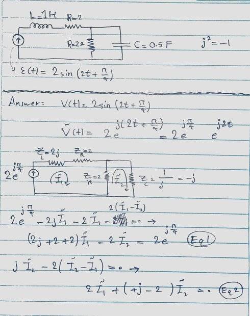

Consider a circuit containing resistors, capacitors, and an inductor. At time t=0, the circuit is closed. Determine the steady current flowing through the inductor and capacitor as a function of time.
KVL and KCL
The picture of the question and my try:
Would it be possible for someone to double-check my answer for accuracy? I would greatly appreciate any feedback or guidance on this matter.

You appear to be familiar with complex impedance etc. So why not work out ##\bf I = V/Z## ?

I wanted to use KVL law to solve. I just realize that working with the equation you stated is better here, because we have only one battery. Thanks.
The solution provided by the original poster in the post #2 is confusing at the beginning. In the circuit diagram the symbol, which is used for the generator, is a symbol for a current source, but in the equations the expression $$ 2\sin(2t+\frac{17}{9}) $$ is used as an expression for a voltage source.

I just found that why my answer in OP is wrong. Thank you for your help @BvU ...
Your post shows that I should only use LATEX , That's not ##17/9## , it was ##\pi /4##!
And you're right. I shouldn't have changed that symbol.
