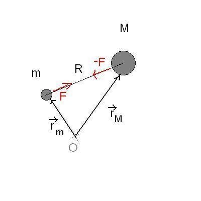

Two particles of mass m and M undergo uniform circular motion about each other at a separation R under the influence of an attractive force F. The angular velocity is ω radians per second. Show that R = (F /w 2 )(1/m + 1/M).(Kleppner & Kollenkow !st ed. problem 2.4)
$$F=m (or M )ω^2R$$
This problem is quite easy to solve using the concept of center of mass. However, the book mentions that until later. How could this be solved just using kinematics and Newton's Laws?

The particles attract each other with force F, and move along circular paths with radius r1 and r2, but with the same angular speed. Write the equation F=ma for both of them, where F is the force of attraction, but it is also the centripetal force.
r1 + r2=R , the distance between the particles.
Thanks for the quick reply ehild. I guess the wording is just faulty. The statement "Two particles of mass m and M undergo uniform circular motion about each other at a separation R under the influence of an attractive force F" should say "Two particles of mass m and M, separated by a distance R, undergo uniform circular motion about a point on the line connecting them". However, how could one prove that this motion around a central point would occur in this system using Newton's Laws?
One could say the the attraction of the particles towards each other would cause the centripetal acceleration of the system, but I can't see how this would impede an analysis with one particle as a reference frame (i.e. as R=0), other the the creation of fictitious forces.

Imagine those "particles" are twin stars, m and M. If you happen to stay on M you see the other one orbiting about your star. If you are on m, you observe M orbiting about you. Those orbits might be circles. The sentence "Two particles undergo circular motion about each other" means that.
If you are an observer somewhere at point O, the position of M is ##\vec r_M## and the position of m is ##\vec r_m##. You know that the particles attract each other with force ##\vec F## along the line connecting them.
So
##m \ddot {\vec r} _m = \vec F \rightarrow \ddot {\vec r}_m = \vec F /m ##
##M \ddot {\vec r}_M = -\vec F \rightarrow \ddot {\vec r}_M = -\vec F/M##
Subtract the second equation from the first. The left-hand side is the acceleration of m with respect to M and you know that m orbits about M along a circular orbit...

Hey, all. I'm doing this problem now and have a solution, but I'm worried my solution doesn't comply with the wording of the problem. I've drawn the system I used:
I marked the separation for my radii arbitrarily, but made sure to not mark it such that the two halves were equal (that is, such that the mark was placed at ##R/2## for reasons that will be explained. I have ##|\vec{F}| = |\vec{F_m}| = |\vec{F_M}| = F##. Because ##M \neq m##, I know that ##a_M \neq a_m##. The acceleration is ##r \omega^2## (I've ignored the negative sign because I'm looking at absolute values). Because ##\omega## is the same for both, that leaves my ##r## terms to be the source of differing accelerations. So, I have $$\frac{F_m}{m} = r_{m}\omega^2 \qquad \frac{F_M}{M} = r_{M}\omega^2$$ $$\frac{F}{M\omega^2} + \frac{F}{m\omega^2} = r_m + r_M = R$$ Or, as desired, $$R = \left(\frac{F}{\omega^2}\right)\left(\frac{1}{M}+\frac{1}{m}\right) $$
