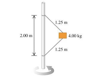

The 4.00- block in the figure is attached to a vertical rod by means of two strings. When the system rotates about the axis of the rod, the strings are extended as shown in the diagram and the tension in the upper string is 79.0 .
A) What is the tension in the lower cord?
B)How many revolutions per minute does the system make?
C)Find the number of revolutions per minute at which the lower cord just goes slack.

(1^2) + (L^2) = (1.25^2) , solving this gives me that the mass is .75 m from the rod
Arctan(1/.72) = theta , theta = 53.13
Necessary inward force: (v^2)/R * m
For upper string: ((v^2)/.75) *m = 79cos 53.13 this leads to m*(v^2) =35.55
That was all I could figure out so far.
Any help would be greatly appreciated. I have been working on this problems for a day and a half, and I just can't seem to solve them. Thanks in advance.
OK. That's the net inward force on the mass.
The tension from the upper string is not the only force acting on the mass.

Ok. For the second problem I have done the following:
Net horizontal force: (v^2)/R * m
Adding the horizontal components of the tension of both ropes and setting that equal to the net horizontal force gives me:
79cos53.13 + (Tension of second rope)cos53.13 = m(v^2)/.75
this simplifies to:
(tension of second rope)=((V^2)-8.89)/0.11
I can't figure out what the velocity is though, so I am not able to finish this solution.
Any suggestions?
thebrandon said:
Any suggestions?
Analyze the vertical forces acting on the mass.
