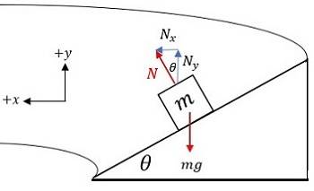

A car at rest under the equilibrium of weight, reaction and friction on an circular bend, suddenly starts accelerating and travel in a circular path. It accelerates until the velocity reaches the maximum possible velocity that can be achieved while remaining in the same radius. Please explain how the friction changes (partial friction) from the the beginning to this moment.
I mean I do get it that, in order to increase the the tangential velocity, the centripetal acceleration has to be increased. As both the angle and reaction force cannot be changed, the only option is to change the friction and get its component to provide additional centripetal acceleration. When that happens how does the car remain without falling under the mg sin theta component, when theta is the angle of inclined plane to the horizontal?

There are only two forces acting on the car:
- gravity (constant)
- contact force with the road (will adjust to whatever is needed to ensure the prescribed kinematic).
Friction is just a component of the contact force. The other is the normal force. They can both change, but their ratio is limited by the coefficient of static friction.

An increase in tangential velocity (i.e. tangential acceleration) is actually caused by a tangential force. As a result, centripetal acceleration increases.
The normal reaction can change. The things that can't change here are the weight, angle and the coefficient of limiting friction.
As an extreme example, consider a motorcyclist on the 'wall of death' (look it up if this is unfamiliar). The normal reaction force (##F_N##) gets so large that the limiting static frictional force (##\mu_s F_N##) is sufficient for the motocyclist to drive on a vertical wall without sliding down!

Also note that the centripetal force here is the sum of:
- the horizontal radial component of the normal force;
- the horizontal radial component of the frictional force.
Edited - 'horizontal' corrected to 'radial'. Explanation if needed: for the normal force, the horizontal and radial components are the same thing; this is not true for the frictional force because there is tangential acceleration.

The way I see it, there are more reasons for the car to try sliding down the incline (towards the center of the curve) at low than at higher tangential velocities.
In a practical case, steering is the only way to manage the net friction force of the tires in such a way that the car remains describing the same circular trajectory at different velocities.

Sure, but it is not right here either. Because of the tangential acceleration, the horizontal component of the frictional force here includes a tangential component.

When the car is at low tangential velocity, friction acts opposing to the component of weight but when it is at high tangential velocities it act in the same direction as the weight component. How does that not create an resultant force.

That is true of the component of friction along the line of greatest slope, i.e. normal to the velocity here. But since the vehicle is accelerating there is also a horizontal component.
Let the normal force be N, the velocity v=v(t), the tangential acceleration be ##a=\dot v##, the horizontal component of friction be ##F_x## in the direction of travel and the upslope component be ##F_y##. What equations can you write?
