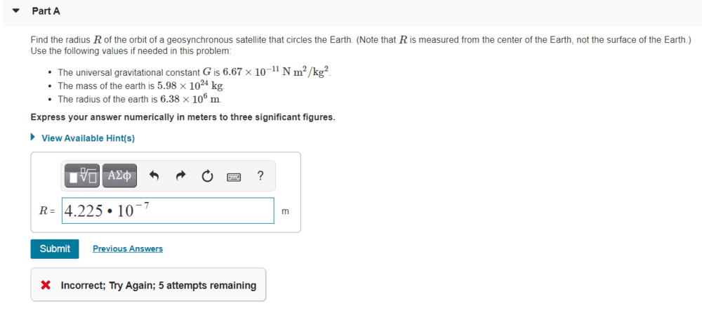

Find the radius R of the orbit of a geosynchronous satellite that circles the Earth. (Note that R is measured from the center of the Earth, not the surface of the Earth.)
The universal gravitational constant G is 6.67×10−11Nm2/kg2.
The mass of the earth is 5.98×1024kg.
The radius of the earth is 6.38×106m.
r^3 = (G*Mass of Earth*T^2)/(4pi^2)
Using Kepler's Formula, I tried to solve for the answer but was told that it's incorrect.

Doesn't ##4 \times 10^{-7}m## seem just a little small for a satellite orbit?
  • Haha
But that's what the calculator said!
Also, 24 x 60 is not 86400. There are 86400 seconds in a day, but that's not 24 x 60.
Ahh I apologise. It's a silly mistake I've made, shouldn't have rushed through things. Thank you all for the valuable inputs!
