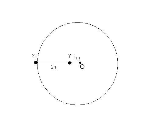

two spheres of equal mass are attached to a light wire of negligible mass of length 3 m ,as shown in the diagram attatched, the spheres and the rod are whirled about point O at a constant rate.
F=ma
a= 4pi^2r/T^2
Find:
(the tension in the wire between spheres X and Y)/(Tension in the wire between sphere Y and O)
Finding the "Tension in the wire between sphere Y and O":
acceleration = (4pi^2(1))/(T^2) since r=1m
From f=ma
there are two masses flying around so ill let the mass equal to 2m.
therefore F= 2m x (4pi^2)/t^2
I don't know how to approach the rest of the problem. I don't even know if I've done it correctly so far.
You know the acceleration of each mass from your formula. The force acting on the mass X is the tension in the wire between X and Y. The force acting on Y is the difference in the tension between X and Y and that between Y and O (since they pull in opposite ways on Y). Now use F=ma. What must the ratio of the tensions be to give you the ratio of the accelerations you need?

Who said there was a centrifugal force? I was talking about the tension forces. They are real forces, and the accelerations are real accelerations. Use F=ma. No fictitious forces here. What's the net force acting on X and what's the net force acting on Y?
Ok But for f=ma should i use 2m for Y and just 1m for X? Why are the pulling opposite ways?
Ok But for f=ma should i use 2m for Y and just 1m for X? Why are Y being pulled opposite ways?
The sphere are of equal mass, use m for both. A tension along a wire pulls the body it's attached to in the direction of the wire. Y has two wires attached to it. One connects it to the center, the other connects it to the outer mass. They are pulling it in different directions. Call TXY the tension in the XY part and TOY the tension in the OY part. In terms of those, what's the force on X and what's the force on Y?

Don't panic. You have some of this right. Besides Wednesday is a long ways away. Yes, that's the picture. You have to consider the two masses separately. aX=TXY/m. aY=(TOY-TXY)/m. As you said aX=3*aY. Can you put that all together to find TXY/TOY=3/4?

TXY/TOY = 3/4

I think that's basically ok, though you are sort of mixing up forces and accelerations. The ONLY forces are the tensions TXY and TOY. The force on X is TXY inward. The force on Y is the sum of TOY inward and TXY outward - for a total of TOY-TXY inward. The 'reaction' force isn't exactly a reaction force, if you have a massless wire under tension it will create equal and opposite forces at either end. That's just because the wire is massless, so the net force on it must be zero.
