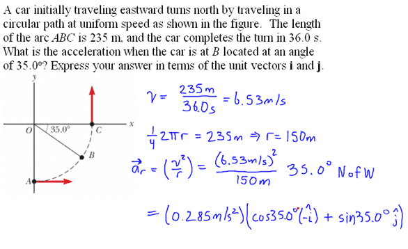

haha1234 Messages 109 Reaction score 0 Thread starter Dec 16, 2013 #1 Homework Statement Homework Equations The Attempt at a Solution Why the centripetal acceleration is negative in i direction and positive in j direction? Attachments ???.png 20.9 KB · Views: 472

haruspex Science Advisor Homework Helper Insights Author Gold Member Messages 42,978 Reaction score 10,571 Dec 16, 2013 #2 haha1234 said: Why the centripetal acceleration is negative in i direction and positive in j direction? From B, which way does the vector -i cos 35 + j sin 35 point? What direction would you expect the centripetal acceleration to be in?

BeBattey Messages 59 Reaction score 6 Dec 16, 2013 #3 I recommend graphing the vector on your diagram, then graphing the vector alone. Plotting vectors always helps! Good luck.
