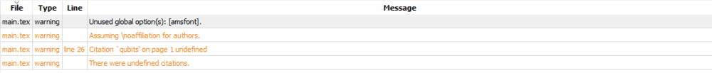

When I am building the pdf, the citations are not coming. Refer to the attached file. Now I cannot build the pdf. It is saying that the process exited with errors, but is giving only warnings:
LaTeX compiler log table with columns File, Type, Line and Message, listing four warnings for main.tex: unused global option amsfont, assuming noaffiliation for authors, citation qubits on page 1 undefined at line 26, and there were undefined citations.

In general, to get a PDF produced properly you have to do the following after making any change to the source file:
1. Run PDFLaTeX. This will produce undefined citation errors.
2. Run BibTex.
3. Run PDFLaTeX. This will produce "citations may have changed" and "page numbers may have changed" warnings.
4. Run PDFLaTeX.
(Steps 1 and 2 can be omitted if you haven't added or removed any citations from the .tex file or made any changes to your .bib files since the last time you ran it.)
Now when I tried this with your source file, BibTex raised an error at Step 2:
This is BibTeX, Version 0.99d (MiKTeX 2.9.6880 64-bit) The top-level auxiliary file: test.aux I couldn't open database file ref2.bib.bib ---line 20 of file test.aux : \bibdata{testNotes,ref2.bib : } I'm skipping whatever remains of this command
Replacing "\bibliography{ref2.bib}" with "\bibliography{ref2}" fixed this.
Thanks, that solved the problem (from TexStudio and command line).
