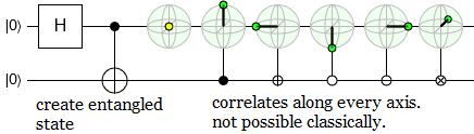

You know how, classically, three bits can be in the state 000, 001, 010, 011, 100, 101, 110, or 111 and so, quantumly, three qubits can be in any linear combination of those eight states? The authors didn't make a classical system with ##n## (3) pieces, one for each qubit. They made a system with ##2^n## (8) pieces, one for each basis state. Each basis state specifies all parts of the system, so their pieces are inherently non-local w.r.t. the system they are supposed to represent.
(To apply a local operation within the simulated system, they need to make all eight pieces do something. Only making one piece do something would apply a non-local operation within the system.)
In other words, they made an esoteric simulator and then avoided just saying that directly in the summary. They didn't violate the Bell inequalities anymore than I did by using Quirk to make this:
Quantum circuit diagram: qubit 1 starts |0>, Hadamard gate H, then CNOT onto qubit 2 |0>; Bloch spheres follow with measurement-basis gates and output dots; caption reads create entangled state and correlates along every axis, not possible classically.
(Oh gosh, alert the presses! I s̶i̶m̶u̶l̶a̶t̶e̶d did something that's not possible classically!)
