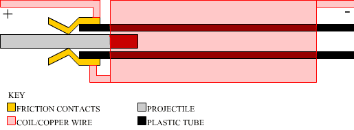

First, like Dr.D said, you need to switch your coils at just the right time. For my own coilguns, I've always used a setup like this:
The idea is that the projectile itself acts as a switch for the coil. Once it travels between one third and half of the length of the coil, the contact breaks and the magnetic field collapses. If you're smart about your circuit, you can actually re-claim the energy left in the magnetic field for the next shot, or additional stages.
Keep in mind that the magnetic field will take some time to collapse, and also that the force on the projectile becomes very small towards the center of the coil. There isn't much benefit to making the projectile go all the way to the halfway point before switching the coil off - in fact, doing so may actually slow it down again because the magnetic field doesn't collapse instantly.
