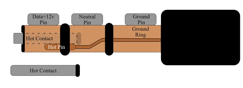

Coaxial plug/socket for line level power with an extra pin for data or DC.
I was reading about someone building a DC house, because this would make solar+battery more efficient. I was wondering what those plugs would look like, but found that there didn't seem to be any standard for DC 120v plugs and sockets. So I thought I'd try to make one, just for kicks:
This is based loosely on the 12v coaxial cable that most AC/DC adapters use. I figured that for 15A it would need to be bigger. It has four pins and so can carry both AC and DC, or 120v and 240v, or maybe AC and data. In the latter case, I'd figured the inner pin would be hot, while starting from the tip would be neutral, data, and ground. That way any foreign object being inserted in the plug would touch ground before anything else.
Those 12v coaxial connectors can rotate in their sockets. I figured that would be bad at 15 amps, so I made it square instead of round. It still inserts four ways. Any thoughts?
It is standard practice these days for the ground connection to be made first and broken last when HV connectors are inserted or removed. This is in most safety standards.
Also, it looks kind of expensive, but IDK.

When you insert it, the ground would momentarily touch the neutral and the data pin before grounding the device, but would still connect before the hot wire. (So maybe the pin closest to the handle ought to cary data instead?). For clarity, I drew the internal metal visible in the hole, but it perhaps ought to be further back to assure it connects last.
This shouldn't cost much more than a headphone jack to manufacture. It doesn't need to be copper, the image just came out that way.
I'm presuming that the data pin isn't competing with ethernet, but is for USB 2 speeds. This is good for authentication and security, since physical access is necessary to connect to the network. The main thing I don't know how to calculate is if this will cary 15A safely.
Would the jack for it be big enough to admit the finger of a toddler? I see ground would be outermost, but that could still result in a nasty injury. It also looks like something conductive inserted in there could short several circuits together.
As you insert the connector, different circuits of the load would contact the wrong pins, no?
It looks too easy to come into contact with live pins as the connector is pulled out (mind you, so does the one on the left). Being a sequential connector, it would be hard to solve that with sleeved pins.
No fuse(s)? Coming from the UK where they’re standard, I might be biased, but does it not make sense to protect the appliance flex from setting on fire?

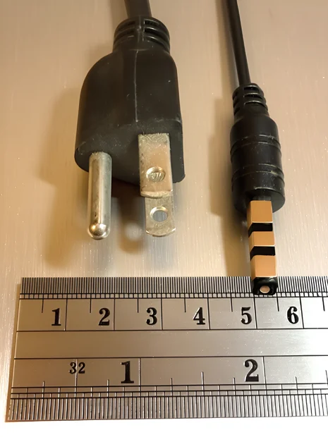

It's about the size of a 1/4" headphone jack, so a toddler's finger would not fit. Also, the tip of the hot pin inside the socket (not shown) would be non-conductive. A fuse could be added by making the handle a bit larger. We have these in the US, but I've only ever seen them on christmas light strings. Since the plug is polarized, only one would be needed.
Would it be big enough for 15A conductors?
Again, thinking through the sequential connection, when inserting the jack you would briefly connect N and ground. This could trip an RCD (GFCI) and rule out the design in the UK and EU.
I think there must be more to this jack than it appears. Those conductors are going to wipe across other (the wrong) conductors as the jack is inserted. IMO, the live and neutral in the receptacle must be lifted away from the rings on the jack or the could be an Earth-Neutral contact on the way in as the Load L and N go past the supply N and Earth. That would trip an RCD (above).
I guess I'm just re-stating the "shutter" word but the L and N should not be available till the jack is sitting snugly in position. Perhaps the hole down the centre could locate round a pin to make the mechanism work.

sophiecentaur said:
I think there must be more to this jack than it appears. Those conductors are going to wipe across other (the wrong) conductors as the jack is inserted. IMO, the live and neutral in the receptacle must be lifted away from the rings on the jack.
Yes, that is a good idea. I was worried about how close the neutral and hot pins in the socket would have to be to each other, and if there was risk of them making contact when no plug was inserted.

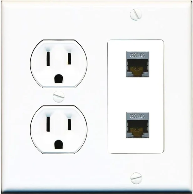

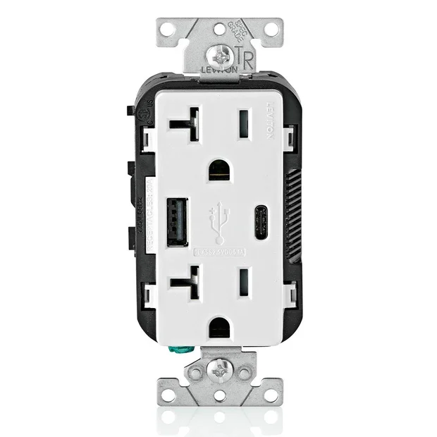

I'm finding these products on the net:
I have the first one in my home. I presume this is okay because the USB only provides power and not data? I asked Amazon's AI if the second one was legal in the US, and it said "Check local regulations."

I would make it triangular and keyed so it's impossible to plug in 120 degrees off.
That is the opposite of what I had in mind. Having to rotate the plug all over to find the right orientation can be a real pain in cramped situations. I designed it so orientation is irrelevant, like in headphone jacks and the EIAJ connector.
Averagesupernova said:
Or to claim they are above safety.
I am indeed above safety, but then I trip and fall on the safety and damage it. Ouch!
Agreed. Is there another way to maintain order of contact without excessive complexity? I can see a peg in the end of the plug that would activate all of the contacts at the last moment. Reliability, size and complexity becomes an issue. A triangular plug with redundant contacts all around would be closer but still require lining up. Three contacts on each side for hot, neutral and ground in the receptacle. But only one on each side of the plug. No matter how it's shoved in the correct contacts always line up. Still requires alignment +/- 60°.
Could have a center peg for ground in the receptacle that goes up the center of the plug and sleeve and tip with the sleeve being larger on the plug. This could satisfy the order of contact and prevent contacts matting that are not supposed to. Reliability could be an issue. It's not likely to be adopted for AC to replace what we have. Higher voltage DC is unlikely to be utilized due to the issue of extinguishing the arc on switch contacts. Low voltage would be fine but it's not likely necessary to require a third wire for ground when the dc voltage gets low enough to be considered safe concerning switch arcing. Still, it never ceases to amaze me the number of various connector types that exist.
Here we go. I'm not sure if these areas are properly called "rings" when the plug is not round, but this is the term I found in my search.
We can prevent the rings from connecting ground and neutral together by having the insulation rings bulge outward from the pin. That way when the plug is inserted, the pins are pushed away from either ring when they might contact more than one. The hot contact is the last to connect, because the plug has to be fully inserted for that pin (Built into the plug) to get over the insulator.
Copper color indicates the plug, grey is the socket. The hot contact is shown twice for clarity, and is actually inside the rings.

^ That might do it. Only concern is long-term wear of the plastic insulation rings being rubbed against metal pins.
The problems of child safety, order of contact and DC arcs could be solved by fitting the socket with an interlocked switch - only closable when a plug is inserted, and locks the plug in place until opened.
Could be. A wider right with a more gentle bulge would allow thousands of inserts before wearing out. Also, these bulges provide some resistance to the plug pulling out, so that the pins don't need to apply too much friction. Is there a safety issue with making a plug too difficult to remove? In an emergency, being able to yank the plug out quickly would be good.

It occurs to me that the socket I drew above has a flaw: If the plug is not inserted, the 12v+data pin might touch the hot contact. This flaw also exists in real-life DC coaxial plugs, but since those only carry 12 volts and no data, it might not be such an issue. I suppose I could eliminate this issue by using the internal pin for data and making it longer and shielded so that it would not touch the hot pin.
Or I could eliminate the internal component and just have four external contacts. That would be simpler, but might make the plug too long, or limit how many amps it could cary.
