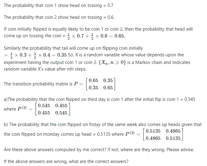

Suppose that coin 1 has probability 0.7 of coming up heads, and coin 2 has probability 0.6 of coming up heads.
If the coin flipped today comes up heads, then we select coin 1 to flip tomorrow, and if it comes up tails, then we select coin 2 to flip tomorrow.
If the coin initially flipped is equally likely to be coin 1 or coin 2, then
a)what is the probability that the coin flipped on the third day after the initial flip is coin 1?
b)Suppose that the coin flipped on Monday comes up heads. What is the probability that the coin flipped on Friday of the same week also comes up heads?
My attempt to answer this question:
The probability of getting a heads on Friday has to be at least 0.6 (why? You can actually conclude 0.65 before doing any real math) so I think you've done it wrong.
My suggestion is to track as your state which coin you are flipping, and to compute the probability of getting a heads on a step, just do that from the game state as a second calculation.

Why have you posted an image of your workings? This makes it harder to reply, we have to type everything from scratch.
You start to go wrong in your third sentence: you should not be adding together probabilities for different initial states, this is the job of the transition matrix. Before you write the transition matrix you need to work out what states you are transitioning between. I would choose state 1 = coin 1, state 2 = coin 2 (although it doesn't matter if you choose state 1 = heads, state 2 = tails).
So the first entry in the transition matrix is the probability of transitioning from coin 1 to coin 1: this is the probability of tossing heads on coin 1 = 0.7.

I think the correct transition matrix is ## P = \begin{array}{c c} & \begin{array}{c c } coin1 & coin2 \\ \end{array} \\ \begin{array}{c c } coin 1 \\ coin 2 \end{array} & \begin{bmatrix} 0.65 & 0.35 \\ 0.65 & 0.35 \end{bmatrix} \end{array}##
So, the answer to a) The probability that the coin flipped on third day is coin1 given that the initial flip is coin 1 = 0.65 ## P^2 = \begin{bmatrix} \underline{0.65} & 0.35 \\ 0.65 & 0.35 \end {bmatrix}##
Answer to b): The probability that the coin flipped on Friday of the same week also comes up head given that the coin flipped on monday comes up head = 0.65 ## P^4 = \begin{bmatrix} \underline{0.65} & 0.35 \\ 0.65 & 0.65 \end {bmatrix} ##
That is not correct - it isn't even a transition matrix: the row labels and column labels should be the same.
The first entry should be the probability that if the current coin to be thrown is coin 1 the next coin to be thrown will be coin 1.
Also the answers are not transition matrices, they are probabilities.

I still think you haven't written down the correct probability that if you flip coin 1, your next flip is also coin 1.

But the problem states that if you are in state "Coin 2" then the probability of flipping a head and going to state "Coin 1" is 0.6. That is not the number you have in the table. You do not have a transition matrix between the states that you indicate.

I do not understand why you think that introducing 6 states where 2 are sufficient is a simplification. It is not, it is an unnecessary complication and one that results in workings that will not relate well to what the OP has been taught.
The selection of coin1 and coin2 as the states is perfectly correct, but the probabilities are all wrong as @Orodruin has said.

I understood what did you mean to say? That's why I computed the probability of head on flipping of any one of the coins (1 or 2).
My method to answer this question:
The probability of head on flipping anyone of the coin 1 or 2, both of which are equally probable, is ## \frac12 \times 0.7 + \frac12 \times 0.6 = 0.65##
If on the flipping of the coin 1 or 2 , head comes up with probability 0.65, we select to flip coin 1 tomorrow with probability 0.65 otherwise we select coin 2 tomorrow with probability 0.35.
Your method to answer this question:
Now, as per your suggestion, Transition probability of matrix ##P =\begin{array}{c c} & \begin{array}{c c} coin 1 & coin 2 \\ \end{array} \\ \begin{array} {c c }coin 1\\ coin 2 \end{array} & \begin{bmatrix} 0.7 & 0.3 \\ 0.6 & 0.4 \end{bmatrix} \end{array}##
Answer to a) as per your suggestion using P, the third day means a day after tomorrow. Hence the answer is ## P^2 = \begin{array}{c c} & \begin{array}{c c} coin 1 & coin 2 \\ \end{array} \\ \begin{array} {c c} coin 1 \\ coin 2 \end{array} & \begin{bmatrix} \underline{0.67} & 0.33 \\ 0.66 & 0.34 \end{bmatrix} \end{array}##
Answer to b) as per your suggestion using P, is ## P^4 = \begin{array}{c c} & \begin{array}{c c} H & T \\ \end{array} \\ \begin{array} {c c} H \\ T \end{array} & \begin{bmatrix} \underline{0.65} & 0.35 \\ \underline{0.65} & 0.35 \end {bmatrix}\end{array}##
Answers to both the questions do not differ much using any of the method given above.

The coins are not equally probable (except the first day). Since both coins favor heads, it is clear that coin 1 will be flipped more frequently.

The answers differ a lot considering they could obviously only be in the range 0.6-0.7.
The answer to part (a) is not 0.65.
If the initial state vector is ## \tau_0 ## and the transition matrix is ## P ## the state vector for the coin to be thrown on the 1st day after the initial throw is ## \tau_0 P ## and so the state vector for the coin to be thrown on the 3rd day after the initial throw is ## \tau_0 P^3 ##. Your answer is a single entry in that matrix element of that state vector and it should be given exactly (it has 4 fractional digits).
The answer to part (b) is not 0.X (I'm not sure what you think it is).
If the coin flipped on Monday comes up heads the coin flipped on Tuesday will be coin 1 so the initial state vector is ## \tau_{tue} = (1, 0) ##. The the state vector for the coin to be flipped on Wednesday is ## \tau_{tue} P^1 ## and so the state vector for the coin to be thrown on the Friday is ## \tau_{fri} = \tau_{tue} P^3 ##. The probability that this coin turns up heads is ## \tau_{fri} \begin{pmatrix} 0.7 \\ 0.6 \end{pmatrix} ## which is a scalar and should be given exactly (it has 4 digits after the decimal point).

Answer to a) is ##\begin{bmatrix}0.7 & 0.3 \end{bmatrix} \times P^3 = \begin{array}{c c} & \begin{array}{c c} coin 1 & coin 2 \\ \end{array} \\ \begin{array}{c c} coin 1 \\ coin 2 \end{array} & \begin{bmatrix} 0.667 & 0.333 \\ 0.666 & 0.334 \end{bmatrix}\end{array} = \begin{bmatrix} 0.6667 & 0.3333 \end{bmatrix}##
Hence, the probability that the coin flipped on the third day is coin 1 after the initial flip is coin 1 is 0.6667Looking at the great unfavourable response to my answer to question b) I changed my amswer to b) as follows:
##\begin{bmatrix} 1 & 0 \end{bmatrix} \times P^3 = \begin{array}{c c} & \begin{array}{c c} Head & Tail \\ \end{array} \\ \begin{array}{c c} Head \\ Tail \end{array} & \begin{bmatrix} 0.667 & 0.333 \\ 0.666 & 0.334 \end{bmatrix}\end{array} = \begin{bmatrix} 0.667 & 0.333 \end{bmatrix}##
Hence, The probability that the coin flipped on Friday of the same week also comes up head given that the coin flipped on monday comes up head = 0.667

Neither of those answers is correct; compare them with the hints given in #22.

That would be correct if the initial state vector were ##\begin{bmatrix}0.7 & 0.3 \end{bmatrix} ##, however the question states "If the coin initially flipped is equally likely to be coin 1 or coin 2".
Almost, but if you count through the days you will see that that is the probability that the coin flipped on Thursday of the same week also comes up head given that the coin flipped on Monday comes up head.
