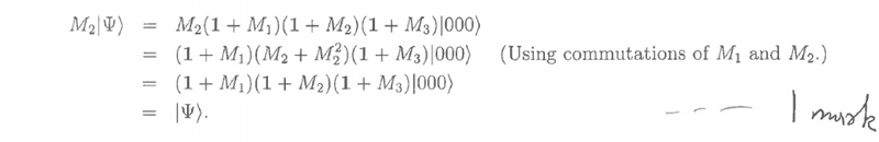

It is known that ##M_1,M_2, M_3## commute with each other but I don't see how the second line is achieved even though it says that it's using that ##M_1## and ##M_2## commute?

Note M2(1+M1) = M2 + M2M1
How can you rewrite the right hand side using the fact that M1 and M2 commute?
##M_2 + M_1M_2##
Raptor112 said:
##M_2 + M_1M_2##
OK. Can you see something you can do with this expression that will help?
##(1 +M_1)M_2## ?
Yes.
