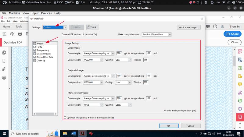

No idea. I downloaded the files as PDF, did not create them. I verified the signature on the documents, and the distilled them. Regarding downscaling images, I am talking about this option in Adobe: Optimize → Advanced Optimization.
Screenshot of the Adobe Acrobat PDF Optimizer dialog in a Windows 10 virtual machine, with Images selected in the left list and Color, Grayscale and Monochrome image settings showing downsampling and JPEG2000 or JBIG2 compression.
Wrichik Basu said:
All documents have already been OCR'ed.
I don't think that's true. I think when you print to pdf you rasterize the entire document, including the text. This makes a massive difference in file size. Like, an oder of magnitude or more. You need the text stored as text. The easy way to check is if the text in the docs is selectable.
