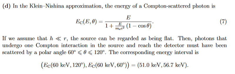

It says that the detector is 60 degrees from the symmetry axis. How can angles other than 60 degrees reach the detector? Wouldn't it be only the scattering polar angle of 60 degrees that reach the detector?
Why specifically a range between 60 to 120?
I can't see it geometrically and compton scattering ranges.

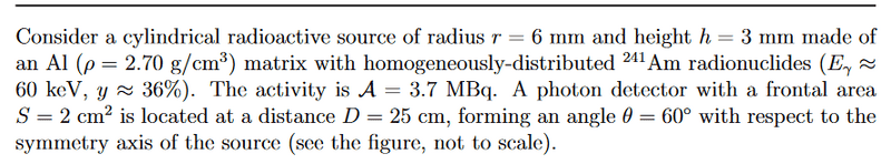

Problem statement text: a cylindrical Al radioactive source of radius r = 6 mm and height h = 3 mm with 241Am radionuclides (E_γ ≈ 60 keV, y ≈ 36%), activity A = 3.7 MBq, and a photon detector of frontal area S = 2 cm² at distance D = 25 cm, angle θ = 60° to the symmetry axis (see figure, not to scale).

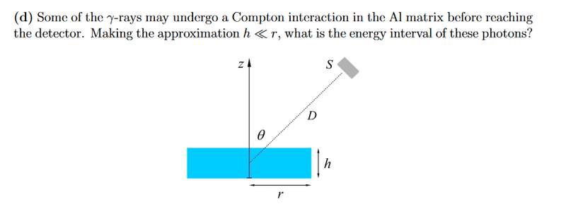

Geometry diagram of a detector setup: a horizontal blue rectangular Al matrix with height h and width r, a vertical z-axis above it, a dotted line from the matrix at angle theta to a detector D and source S at the upper right.
Text excerpt with equation (7): Ec(E, theta) = E / (1 + (E/(me c^2))(1 - cos theta)), and a note that photons scattered between polar angles 60 and 120 degrees reach the detector, giving the energy interval (51.0 keV, 56.7 keV).
Where do the photons come from? What's their direction of propagation before they're scattered into the detector?
The photons come from the Am source in the cylinder. Their directions are isometric, 360 degrees?
Does the approximation that ##h \ll r##—the source is flat—affect your answer?

I'm not sure how ##h \ll r## affects the propagation. It just means that the photons only propagate in 2D instead of 3D?
The polar angle is the angle between incident photon and scattered photon.
In flat source the propagation direction before scatter would be perpendicular to the surface, ie 0 or 180 degrees? And that would mean 60 or 120 degrees to the detector?
But it says 60 to 120 degrees, not 60 or 120 degrees. That would mean that the scatter propagation is not perpendicular to the surface?
I can see that if the photon propagates in perpendicular at top surface +z direction it has to scatter at 60 degrees. And in bottom propagation -z it has to scatter 120 degrees to reach detector.

In order for the scattered photon to reach the detector, I find the range of scattering angle of the photon to be ##30^{\circ} \leq \theta \leq 150^{\circ}## instead of ##60^{\circ} \leq \theta \leq 120^{\circ}##. So, I disagree with the solution given in the OP.

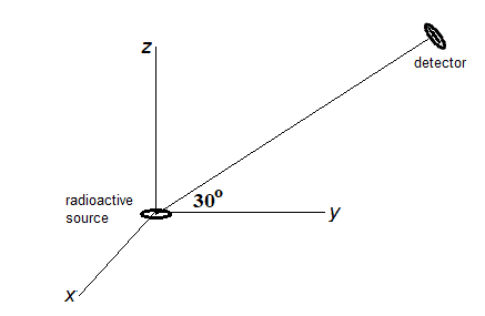

I'm not yet following the answer ##30^{\circ} \leq \theta \leq 150^{\circ}##, let alone ##60^{\circ} \leq \theta \leq 120^{\circ}##.

No. The source is emitting gamma rays in all directions. But only in certain directions do the gamma rays have a significant chance of undergoing a Compton scattering. (Imagine the height ##h## of the source to be infinitesimal compared to the radius ##r##.)

The gamma rays are emitted in all directions.

3D coordinate sketch with z-axis up, y-axis to the right and x-axis toward the viewer; a radioactive source sits at the origin, a line at 30 degrees from the y-axis runs to a detector at upper right.
Let the detector lie in the y-z plane as shown. If a gamma ray is emitted inside the source in the +y-direction, at what angle would it need to scatter in order to reach the detector?
If a gamma ray is emitted in the +x-direction, what is the scattering angle to reach the detector?
How can you get a scattering angle of 150o?

When the material becomes flat there is no attenuation on z-axis, hence no possibility to scatter.
The photons will propagate along x-y-axis, and from there scatter towards the detector, which should indeed be in the range 30-150 degrees.

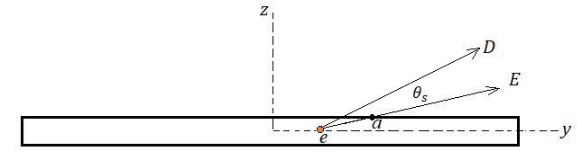

And why can't I get a scattering angle below 30 or above 150 degrees?
Strictly speaking, you could have a scattering angle less than 30 degrees into the detector (or greater than 150 degrees). But, it is very unlikely when ##h \ll r##.
An example is shown in the diagram below. A nucleus at ##e## emits a photon in the y-z plane in the direction of the arrow ##E##. The arrow ##D## also lies in the y-z plane and shows the direction toward the detector. Then it would be possible for the photon to scatter off an electron at some point between ##e## and ##a##.
Diagram in the y-z plane: a horizontal rectangle along the y-axis, a dashed z-axis at the origin, a point e on the left of the rectangle, a point a just right of e, arrows D and E from near e pointing upward-right, and angle theta_s between them.
If the angle between the arrow ##E## and the y-axis is 10 degrees, you can see that the scattering angle ##\theta_s## into the detector would be 20 degrees (thus, less than 30 degrees). But note that the distance ##ea## for which scattering can take place is pretty small. The smaller this distance, the less likely that a Compton scattering will happen. A photon emitted from ##e## along the y-axis, for example, can travel a greater distance inside the material. So the chance of Compton scattering is increased. Then, the scattering angle ##\theta_s## into the detector would be essentially 30 degrees.
If ##h \ll r##, the picture might look like this:
Diagram in the y-z plane: a horizontal bar along the y-axis with a point e and a point a on it, arrows D (to a detector, steeper) and E (shallower), with angle theta_s marked between them at a.
The distance ##ea## is greatly reduced and there is little chance of scattering into the detector. Photons emitted along the y-axis can travel much farther inside the material; therefore, they have a much greater chance of scattering.
I leave it to you to think about emission points ##e## that are not on the y-axis.

Yes, I think you have it.
