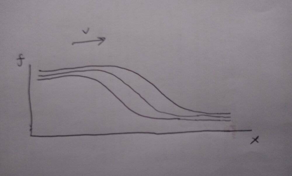

I would like to compute the approximate speed of travelling waves in 2 dimensions using MATLAB.
I have a 2-dimensionsal smooth function ##f(x,y,t)##. There may be multiple traveling waves across the domain. None of them are precisely traveling waves (the shape of the wave changes as it travels). Here is how one of these waves would look in 1-dimension:
I want to find the speed of these waves using MATLAB. (The function is just stored as a matrix of values). I was thinking of applying the wave equation $$\text{squared error}=(\frac{\partial^2 f}{\partial x^2}+\frac{\partial^2 f}{\partial y^2}-\frac{1}{v^2} \frac{\partial^2 f}{\partial t^2})^2$$ It would be an optimization problem where I find ##v## which minimizes the squared error.
I would also like to find the local speed at different ##<x,y>## values. I imagine I could do the same procedure but in a local region around that coordinate.
Would this be a reasonable approach? Would there be way of doing this efficiently? Are there better approaches?
EDIT: I'm only looking for traveling waves like the one sketched above, where there is a change from a lower value to a higher value. Could I use that to make the problem simpler?

Because you saying that there is dispersion(i.e shape of wave changes as it travels), this means that each Fourier component of the function f has a different velocity. So with your approach you will find something like the average velocity over the range of all frequencies. Maybe a different approach is needed to find the velocity of each frequency component, but not sure what approach exactly.
Without more information it is hard to help much. We don't know whether the medium is linear or nonlinear, dispersive or non-dispersive, homogeneous or inhomogeneous, etc. What is the source of this function? Did it come from some kind of simulation or is it a measurement? Of what?
If the waves are changing shape as they propagate then I would not expect them to satisfy that simple equation you wrote. Off the top of my head, the only way that equation might apply is if the velocity is a function of position.

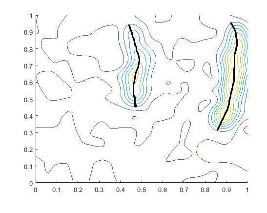

Because I am looking for the speed the crack propagates, I realize I can be more precise with what I'm analyzing. I agree with the idea of analyzing the contours, but all I really need to look at is motion in the long direction (or the length of the crack). Here's a contour map with two cracks, with the location of the cracks drawn on in black:
So I think to find the speed of crack propagation, I could use some sort of an approach like this:
  1. Find regions where ##f## is above some cut-off value (these are regions where there is a crack)​
  2. Find the highest point for each of these regions (I think the crack must cross through this point)​
  3. Construct a curve which passes through this point and is normal to the contours (this is the crack)​
  4. Compare the length of the crack for each step, the difference divided by the time step being the speed​
I think I could code all of this. Do you think this seems like a reasonable approach?

If we think of a crack as a figure bounded by a contour (level curve) of a surface and cracks are long and thin then the growth of the crack would occur at the "ends" and rate would be the combined growth rates of the ends. Considering the growth rates of all the points in the crack normal to the contour, the two points with the maximum grown rates would define how the length of the crack increases.
However, I'm not familiar with phyics of the problem. My general advice is this:
There are probably papers about techniques for analyzing experimental data using pattern detection algorithms to find cracks and measure their properties. If the data from the simulation resembles data from a particular type of experimental image ( visual, x-ray, etc.) look at the algorithms that people use to analyze that type of image. Think of how any results you publish will be evaluated by experimenters.
i assume you are aware of the depth of existing work in this area. My initial thesis topic involved molecular dynamics simulations of crystal dislocations propagating under stress and solitary wave solutions to nonlinear models and this was c.1975. (I decided it was too much computing so I switched topics). My point is I would be surprised if something very close to this does not already exist and it may behoove you to do a very deep literature search. I may be able to resurrect long dead synapses but would need more detail...I never published in the area.
I think cracks for MD simulations are usually analyzed by looking at how the positions of the atoms change over time, where gaps of atoms indicate cracks.
What I like about my approach is that there's a continuous function representing damage which allows for different types of analysis, like a probability of failure map, or a statistical analysis of how damage spreads through the sample.
However, analysis of experimental work would also look at the gap (it obviously can't analyze broken and formed bonds), so maybe the standard approach would be more analogous to experimental work. I'll make sure to ask my research advisor.
