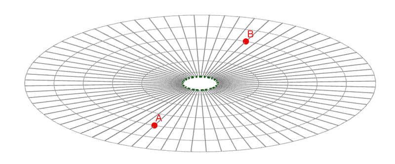

In another thread where this distinction was discussed, I came up with a hypothesis about this that I would like to get feedback on.
Maybe you were talking about this thread spacetime distance between spacelike related events. Events (points) in red on that spacelike hypersurface are actually timelike separated.
