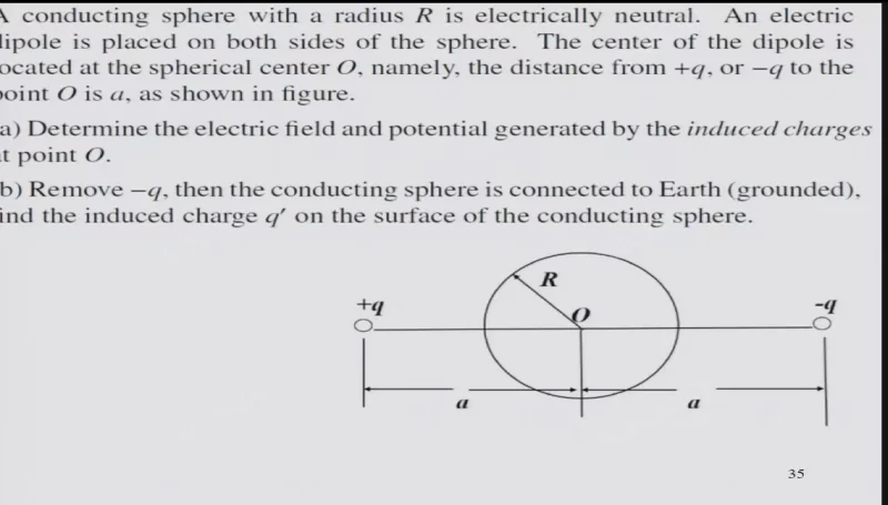

Hi, I'm stuck at this question, please help.
Attempt to the Conducting Sphere and Dipole Problem
(a) Electric Field and Potential at O due to Induced Charges
$$V_O = 0$$
This potential is the sum of the potentials due to the real charges (##+q, -q##) and the induced charges on the sphere.
$$V_O = V_{\text{real}} + V_{\text{induced}} = 0$$
- Electric Field at O, ##\vec{E}_O##: Since point O is inside a conductor in electrostatic equilibrium, the electric field there must be zero.
$$\vec{E}_O = 0$$
This field is also the sum of the fields from the real charges and the induced charges.
$$\vec{E}_O = \vec{E}_{\text{real}} + \vec{E}_{\text{induced}} = 0$$
(b) Induced Charge ##q'## after Removing ##-q## and Grounding the Sphere
$$\left(\frac {q'} {4\pi\epsilon_{\text{0}}a}\right)+ \left(\frac {q} {4\pi\epsilon_{\text{0}}R}\right) = 0$$
Solving for ##q'##:
$$\boxed{q' = -q\cdot\left( \frac R a \right)}$$

Your homework statement mentions dielectrics. But the actual problem statement does not mention dielectrics.
It's not clear to me where, specifically, you are stuck.
$$V_O = 0$$
What is your reasoning for claiming that the total potential at point ##O## is zero?
The problem statement asks you to find the potential at ##O## due to the induced charge only.
$$\vec{E}_O = 0$$
Yes, that looks good. But you still need to determine the field at ##O## due to the induced charge only (and include your reasoning).
You should include some verbal statements that justify this equation.
Did you accidentally switch ##q## and ##q'## in this equation?
jojosg said:
Solving for ##q'##:
OK. This is what you get if you switch ##q## and ##q'## in your previous equation.

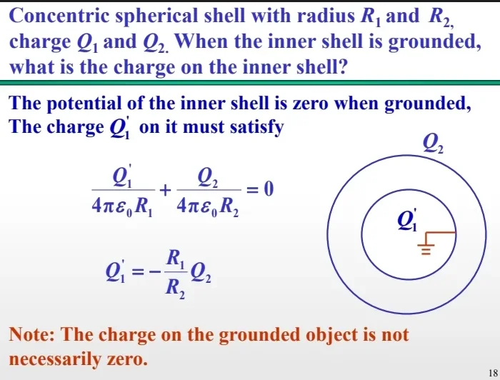

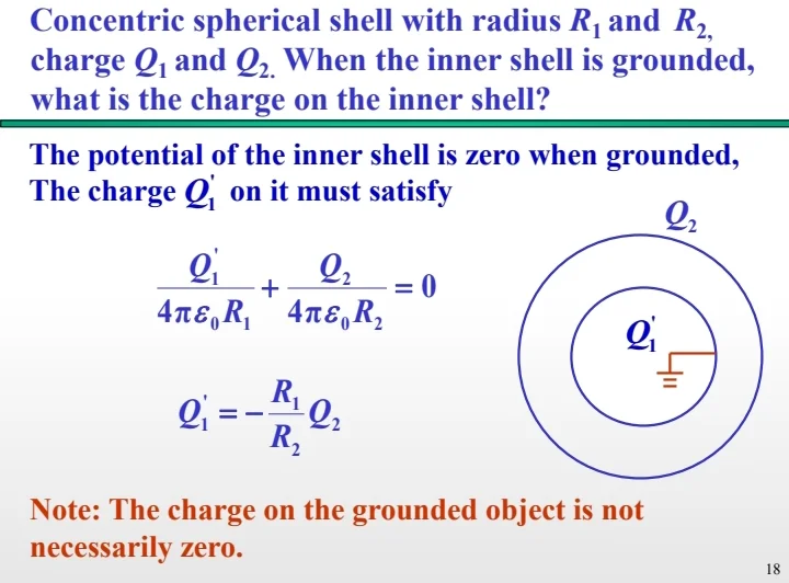

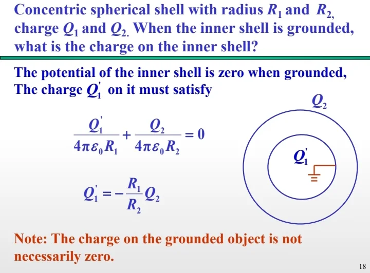

Maybe just stuck at part a with induced charge. For part b I referred to this in my teachers powerpoint.
This problem is not the same as the one given in your first post. It appears to be totally unrelated.
You mention your teacher's powerpoint. So, I'm assuming the picture above is a PowerPoint slide. If you have a question about this slide, you should start a separate thread and ask specific questions about it there. Otherwise, it will get confusing trying to decide which of your remarks refer to the original problem and which remarks refer to this new problem.
