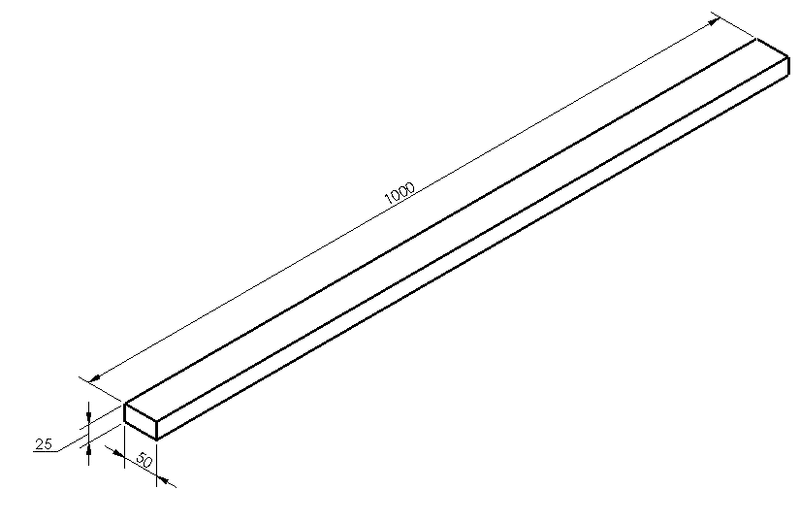

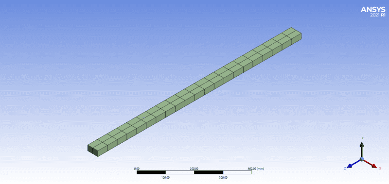

I’ll analyse a cantilever beam of length 1000mm, with a base of 50mm and height of 25mm. A 1000 N load is applied at the free-end of the beam. Young’s modulus is 200 GPa.
Isometric dimensioned drawing of a rectangular cantilever beam: length 1000, cross-section 50 by 25.
I calculate a bending stress of 192 MPa at the fixed end, and a deflection at the free-end of 25.6mm. Total strain energy is 12.8 J.
I add total deformation, equivalent stress, and strain energy as solution outputs. I don’t apply any mesh methods or controls and just let the software do its thing for the first run, and it produces the following mesh.
Finite element mesh of a long rectangular beam made of hexahedral elements, shown in isometric view with a scale bar from 0 to 400 mm and XYZ axis triad.
Running the solver and I’ve tabulated my calculations compared to ANSYS results.

The difference in stress is approximately 5%. Not too big a deal as the material yield stress is 250 MPa. I check the element quality.

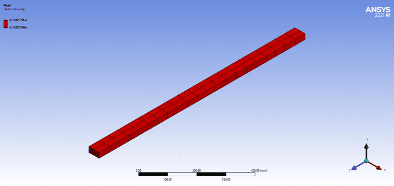

Finite element mesh of a long rectangular beam in ANSYS, with hexahedral elements all coloured red. Legend reads Mesh, Element Quality, 0.74127 Max and 0.74127 Min. Scale bar 0 to 400 mm.
All elements have the same quality of approximately 0.74, and I’m assuming that this is what is causing the discrepancy in the stress? I now apply a body sizing control to the mesh and reduce the element size from 12.5mm to 6.25mm. I expect that the stress will increase as the element size decreases. Second run tabulated.

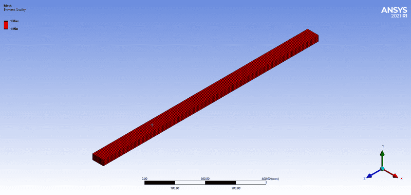

Element quality check on second run.
ANSYS Mechanical mesh view of a long rectangular cantilever beam, fully meshed with red hexahedral elements, with an Element Quality legend and a 0 to 400 mm scale bar.
All elements have perfect quality.
The stress increased as expected. But the strain energy and deformation have barely changed, the element quality is now apparently perfect.

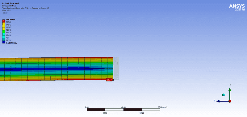

jrmichler said:
One stress concentration that can create problems is the edges around a fixed surface, such as the end that's fixed when you are modelling a cantilever beam. In that case, the fixed end elements that have one surface fixed are not expected to give accurate results.
Taking this into account, I reran the model again using the 6.25mm elements but I've excluded the elements closest to the fixed-end from the solution, shown in the below screenshot.
ANSYS Static Structural equivalent von Mises stress contour plot of a beam with a 0 to 189.4 MPa colour scale, meshed with elements, fixed at the left end; red at top and bottom edges, blue along the centre.
The maximum stress now is 189.4 MPa, pretty close to the calculated of 192 MPa. For this specific analysis, excluding these elements seems reasonable to me.

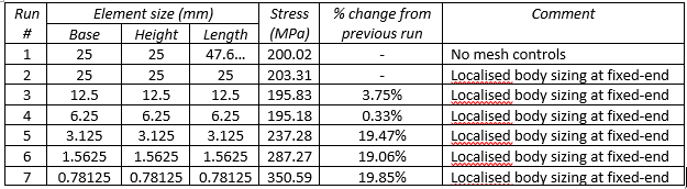

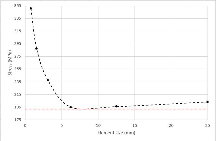

The 6.25mm elements everywhere in this model are definitely overkill, so as recommended I’ve done a set of runs tabulated below.
Table of FEA mesh convergence runs 1 to 7 listing element size in mm (base, height, length), stress in MPa, percent change from previous run and comments; stress values 200.02, 203.31, 195.83, 195.18, 237.28, 287.27, 350.59.
The first run has no mesh controls and let's the system do its thing. After that I’ve decreased the element size near the fixed-end, halving the size for each run and recorded the stress. This is plotted below.
Line plot of maximum stress in MPa against element size in mm, with stress falling steeply from about 355 MPa at 0.8 mm to near 195 MPa at 6 mm, then rising slightly to about 200 MPa at 25 mm; a red dashed line marks 192 MPa.
The horizontal red dashed line is the 192 MPa hand calculation of the stress. The two best performing element sizes were 6.25mm and 12.5mm, but anything between 7mm and 9mm will get very close. In fact, 6.25mm is a bit on the small side but not by much.
Thanks for the advice guys. Is there anything obvious that I’ve missed in this? Is this a reasonable approach to take for more complex parts where I'm not encountering a singularity, home in on regions of high stress and play with the localized element sizes until I find an inflection point in the stress curve to settle on a good element size?
Yes, that's what we generally do (or should do) for each case of new stress analysis. Identify regions with high stress gradients (some codes have tools that make it easier to find them) then keep refining the mesh and checking results on a plot like yours until the difference (not from analytical solution since we usually don't have it but from the previous run) is small enough. Many FEA codes have adaptive remeshing functionality but we rarely use it and prefer to refine the mesh manually.

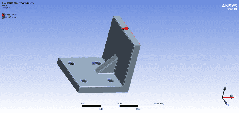

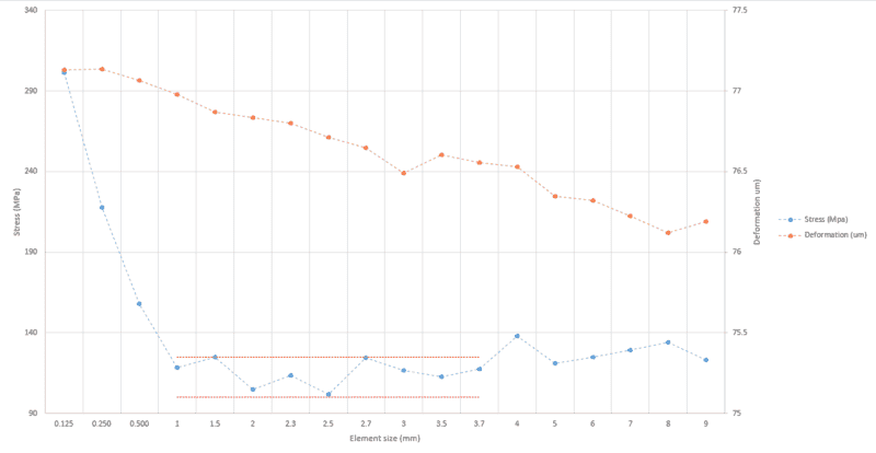

I’ve created a model of a gusseted bracket, screenshot below.
ANSYS Workbench screenshot of a gusseted bracket model with fillets, showing an L-shaped plate with four bolt holes, a triangular gusset and a force of 1000 N applied to the upper flange, with a fixed support marked on the base.
I did a bunch of runs and plotted stress and deformation, below.
Line chart of stress in MPa (blue) and deformation in um (orange) against element size in mm, from 0.125 to 9 mm; stress rises steeply below about 1 mm and fluctuates between roughly 100 and 140 MPa from 1 to 3.7 mm, while deformation falls gradually from about 77.1 to 76.1 um.
Note that the deformation here is in microns, so the changes are very small. I was more interested in the stress values I was getting. When the element size is less than 1mm the stress begins going exponential. I’m not sure that I would say that the stress has converged, but at least it appears to be bounded when the element size is between 1mm and 3.7mm. If I had to pick an element size within that bounded region I’d pick 2.3mm because the difference on either side of it is relatively small. You could argue that an element size of 3.5mm has a difference on either side of it that is even smaller than the 2.3mm element. But I’d choose 2.3mm over 3.5mm simply because it is higher resolution.
Would my selection of the 2.3mm element size be reasonable, or am I missing something?
If I was analyzing that bracket, I would place fillets in all inside corners. Outside corners can be square. Then I would specify a mesh size on the inside corner fillets such that there would be three elements around the fillet (each fillet would be three elements wide). I would start with a coarse mesh in the rest of the model - three or four elements through the thickness of each leg and the gusset. Run that model, check the deformed geometry to confirm proper loading and restraints, and check the stresses for anything that looks wrong.
If everything looked good, and I wanted the best accuracy, I would reduce element size to 2/3 or 1/2 size, and run it again.
I would eliminate the chamfers/fillets on the outside corners. They force either small or sliver elements, depending on how your software meshes the model. Small elements make it run slow, sliver elements cause poor accuracy. Square outside corners are part of normal defeaturing for best running.

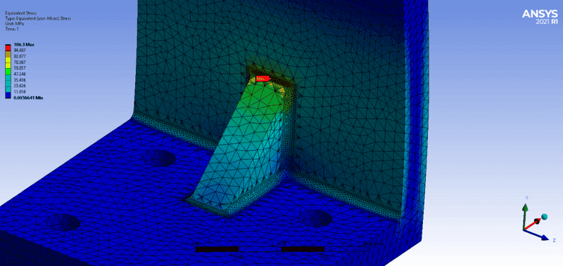

Okay I did this, kept the internal fillets and got rid of the external ones. Did the first run using three elements around each fillet (0.8mm element size), and the second run with half-sized elements (0.4mm element size). Data is tabulated.
Deformation (µm)Stress (MPa)
First run 0.8mm elements51.1104.17
Second run 0.4mm elements51.2105.73
Stress from the second run.
ANSYS finite element contour plot of equivalent (von Mises) stress in MPa on a bracket fillet, with a dense triangular mesh; maximum 106.3 MPa marked in red near the top of the fillet, legend running from 0.0056641 to 106.3 MPa.
I don't like the shape of the elements just above the 'max' annotation, but I was seeing a very similar distribution of stress in the previous runs I did and it wasn't spreading into the region where the now badly shaped elements are.
This seems like a good way to go about analyzing parts like this, thank you again for the advice.

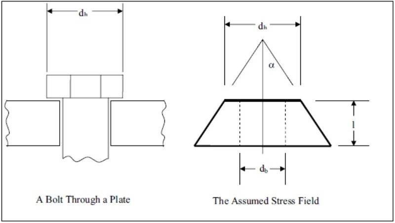

The stress plot looks good, but it should also show the deformed geometry. Deformed geometry plots are a check on the loading and support modelling. Your stress plot appears to show that the entire support surface is fixed. This is not a good way to model this bracket because it distorts the stress results.
There is a better way to model a part that is bolted to a flat surface. Start by reviewing the design of bolted joints (search the term). One popular method is summarized in this diagram:
Two-panel diagram: left shows a bolt through a plate with head diameter dh; right shows the assumed stress field as a frustum of a cone with top diameter dh, half-angle α, height l and bottom diameter db.
It simplifies the stress field for a bolt to a frustum of a cone. When modelling, take the diameter of the bottom of the cone, and fix those areas in your part.
On a small, thick, part with closely spaced bolts such as your part, it will not make a large difference in the results. On other parts, it can make a huge difference. And the results will be much more accurate.
