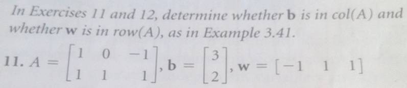

Hello,
in exercise 11, I get b is not and w is, but the answer key says b is and w is not...? I don't understand...have I misunderstood or is the answer key wrong?

I don't know who/what facit is, but he/she/it is correct. Perhaps if you post your solution, we can discuss it.

If we start with col(a)
after row reduce we got 1 0 -1|3
----------------------------0 1 2|-1
that means we got infinity soloution, if we set $$x_3=t$$ we got $$x_2=-1-2t$$ and $$x_1= 3+t$$ it indeed got soloution so it is in col(A)

Yes, but in post #1 you said that $b$ is not in $\text{col}(A)$.

That'S cause I got actually wrong number in My matrice somehow.. Sorry My bad and now I correctly Solved it:)

(3,2) = 3(1,1) + (-1)(0,1). This proves b is in col(A).
On the other question if a(1,0,-1) + b(1,1,1) = (a+b,b,b-a) = (-1,1,1), we must have
b = 1, leading to:
a+1 = -1 --> a = -2
1-a = 1 --> a = 0.
Since -2 is not 0 (unless you are in a field of characteristic two, and then there is no "3"), this is impossible.
