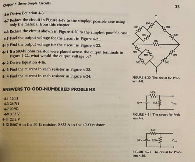

Find the output voltage for the the circuit in Figure 4-22. Find the output voltage if a 500k resistor were placed across the output terminals
##\sum V = 0, \sum I = 0##
The problems I am referring to are problems 4-10 and 4-11.
There is no solution provided for 4-10, so I want to check my answer here. However, I don't understand the answer to problem 4-11. Shouldn't it also be 24 V since it is in parallel with the 200 k##\Omega## resistor? I am actually confused about resistors in parallel. Is there a chance its not in parallel due to the 50 k##\Omega## resistor on the left?

How might the polarity of the circuit's voltage source effect your results?
It is unfortunate that the circuit diagram does not make it clear how to interpret the polarity of Vout where it is labelled.

Im having trouble with 4-11. I found the equivalent resistor. I got:
##R_{eq} = \frac{200,000(500,000)}{700,000} = 143,000 \Omega##
Then I went around the circuit again with KVL. I got
##193,000 \Omega I= 30~V \implies I = 1.55 \cdot 10^{-4}~A##
But then ##V_{out} = R_{eq}I = 30V##
1.55 10-4 x 143 10+3 = 30 ?

Oh no. I was using 193,000. I see now that that was wrong.
rtareen said:
Shouldn't it also be 24 V since it is in parallel with the 200 kΩ resistor?
It's in parallel so that means both resistors have the same voltage across them. It's just that the voltage is no longer 24 V.
