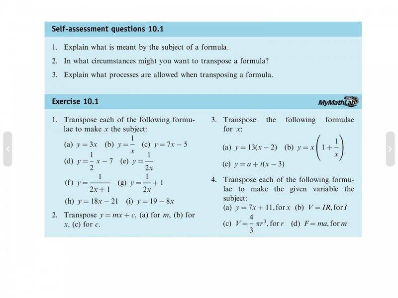

Hello I'm working through transposing formulae of pearsons Anthony Croft and Robert Davidson's foundation maths 5th edition and I'm stuck on exercise 10.1 question 1)e)
We're it states that I must transpose the formula to make x the subject.
The formula is y = ¹/₂x and the answer x = ¹/₂y
I don't understand how they got this answer. As I did the working as
E)y = 1/2x
× 2
(2)(y) = ⁽¹⁾/₍₂₎x × ⁽²⁾/₍₁₎
2y = x
I base this way of a working off another question which I got correct
D)y = (¹)/(₂)(x - 7)
+ 7
y + 7 = ¹/₂x
× 2
(2)(y + 7) = ⁽¹⁾/₍₂₎x × ⁽²⁾/₍₁₎
2y + 14 = x
x = 2y + 14
If I am missing some rule that I'm meant to implement or if there is a error in the textbook your advise would be greatly appreciated.
Yours sincerely Buggsy

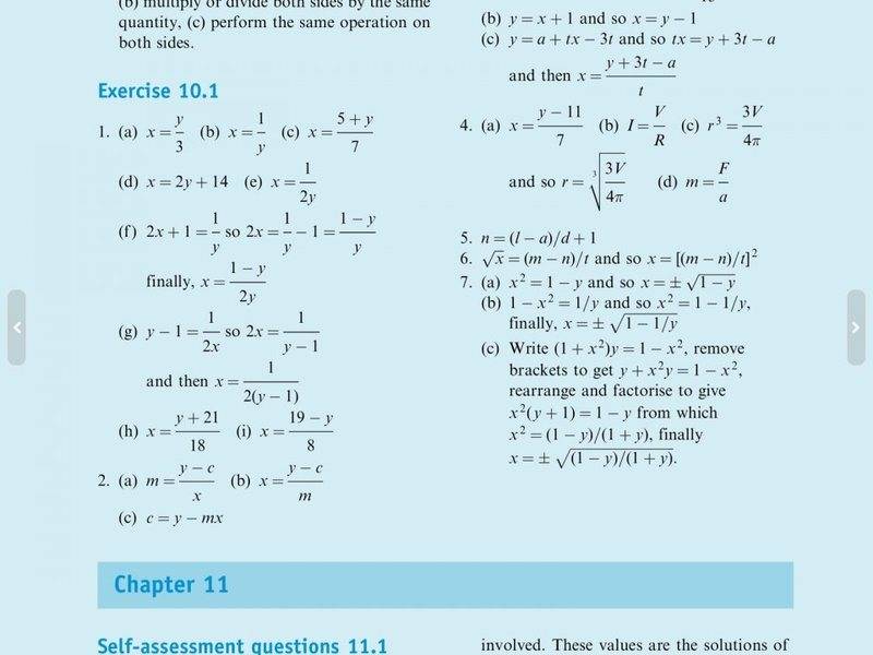

That does not make sense.
If ##y = \frac{1}{2x}## then ##x = \frac{1}{2y}## is correct.
Try ##x = 1## for example.
I know but look
Textbook page titled Exercise 10.1 with numbered solutions to rearranging formulae, such as x = y/3, x = 1/y and x = (5 + y)/7, followed by a Chapter 11 heading.
Textbook page titled Self-assessment questions 10.1 and Exercise 10.1 with questions on transposing formulae, including y = 3x, y = 7x - 5, y = 18x - 21 and y = 19 - 8x, and transposing y = mx + c and V = IR.

That last equation is very different. That is
##y = \frac{x}{2} - 7##
