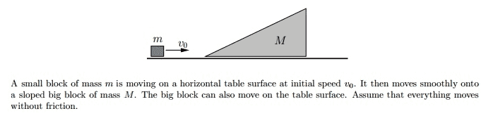

A small block of mass m is moving on a horizontal table surface at initial speed v0. It then moves smoothly onto a sloped big block of mass M. The big block can also move on the table surface. Assume that everything moves without friction
Find the speed v of the small block after it leaves the slope.
Conservation of Momentum: mv0 = (M+m)v → v=(mv0)/(M+m)
Conservation of Mechanical Energy: fairly obvious
The height that it rises to is h = (1/2g)(Mv0^2/M+m), I derived this from conservation of momentum and conservation of mechanical energy
I set up the conservation of momentum: (M + m)v = -mv1 + Mv2 Is this correct?
Now I ask, how should I set up the conservation of mechanical energy equation? Should I solve for one variable in terms of the other? The answer should be in terms of v0.
The answer is v1 = ((M-m)/(M+m))v0
Don't assume that m & M have the same velocity.
Don't worry about the height. That's an intermediate point that we don't care about.
Set initial momentum equal to final momentum. Let v1 and v2 be the final velocities after they separate.
Intial KE = final KE
You'll have two equations. Eliminate v2 and solve for v1.
How would a conservation of kinetic energy equation look like?
1/2(M+m)v^2 = 1/2mv1^2 + 1/2Mv2^2 ?
Conservation of momentum: (M+m)v = -mv1 + Mv2 ?
If I solve for v1 using these equations, it turns out very convoluted and does not resemble the answer. I feel as though it should be cleaner than this. Am I doing something incorrectly?
Does this problem even meet the criteria to use conservation of kinetic energy? It doesn't seem to be elastic, does it?
Please help, this problem has been bugging me for awhile.
OK, except for the left hand side. Initially, only m is moving.
Same issue as above.
Clean up the equations as I suggest and try again. A bit of a pain, but you'll get the required answer with a bit of work.
Wow, it worked! Thanks so much for your help. I greatly appreciate it.
Excellent! :approve: (And you are most welcome.)
