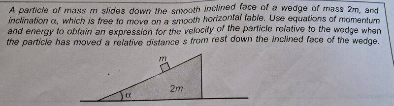

A particle of mass m slides down the smooth inclined face of a wedge of mass 2m, and inclination a, which is free to move on a smooth horizontal table. Use equations of momentum and energy to obtain an expression for the velocity of the particle relative to the wedge when has moved a relative distance s from rest down the inclined face of the wedge.
Pi =Pf , P.Ei + K.E i = P.Ef + K.Ef

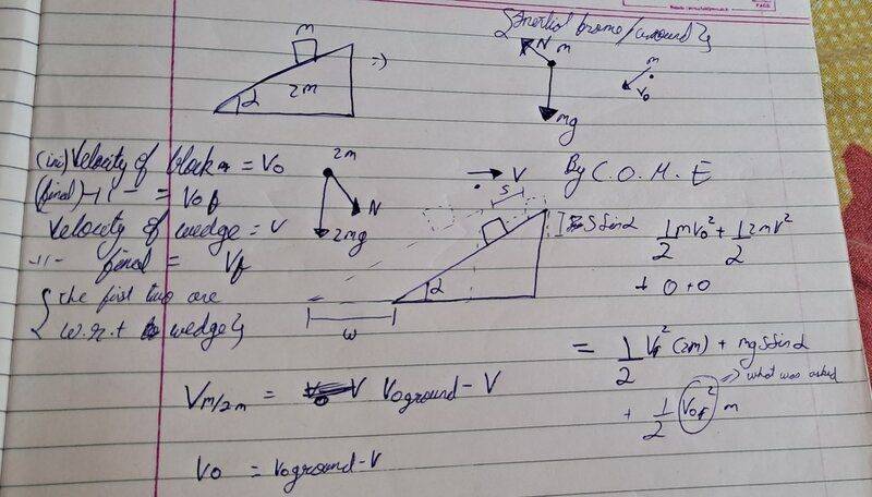

So i am tried to conserve momentum and use conservation of mechanical energy but won't there be psuedo force acting on the block if i am solving from non inertial frame ?. If i ignore the pseudo force and simply use C.O.M.E and include the K.E of the wedge and solve normally i do get the appropriate answer but that doesn't fit right to me .

Welcome @Spector989 !
Could you show us the work that led you to get the appropriate answer?
Why not to solve the problem using an inertial frame of reference, considering the relative movements of particle and wedge?

That is not relevant to the question being asked by the OP, namely, how come the non-inertial frame gave the official answer. But yes, we need to see the actual working to answer that.

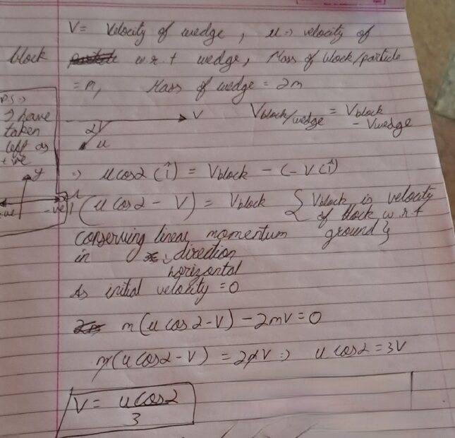

I rechecked what i did and i solved it wrong .. but i did what you told me to and i can't understand what to do further . Btw i took the intial position of block as reference line for gravitational P.E

Mb i solved it wrong , but i tried it solving using inertial frame and i am stuck , will the final velocity of the wedge be different, will the normal reaction between wedge and block be considered internal force if i take them as a system but only objects with same acceleration can be taken as a system right ?

Please, please post the working that you did using a non inertial frame to arrive at the correct answer. Preferably typed in, not as an image. Images are for textbook extracts and diagrams. If you must do it as an image, please make sure it is easy to read and laid out in a sequence, not scattered all over the page.
In the working you posted, it is unclear what you mean by velocity of block. In which direction?

Sorry if i was not clear , The workings i did to arrive at the correct answer through non inertial frame was Wrong , and i have mentioned the direction in the right corner beside the FBD for the block and on the left side of the page for the wedge . I cannot type in the answer as i am not used to typing out equations and i am on a mobile . I solved it by trying it again through inertial frame of reference. I can post it but i can't type it out. I got a relation between Velocity of wedge and block but the velocity of the block will not be constant so i am getting different variables in both sides of the eqn while applying conservation of mechanical energy

I think your equation ##v = \frac{u\cos \alpha}{3}## is correct.
Can you figure out how to calculate ##v## in terms of ##s## using conservation of energy?

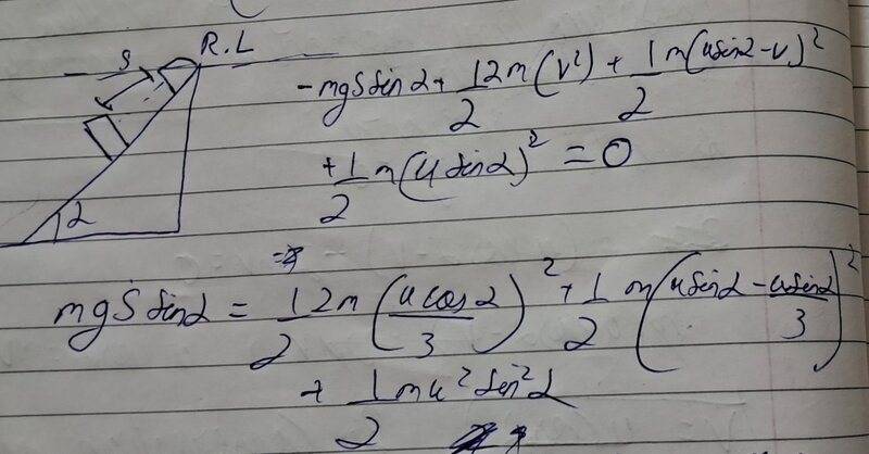

I would work in the IRF. You need to relate the KE of the mass and the wedge to the loss of PE. You need a diagram that shows the mass having slid a distance ##s## down the wedge and the new position of the wedge and the mass. You should have a triangle with base of length ##x + X##, height ##y## and hypoteneuse ##s##, where ##x## is the horizontal distance moved by the mass, ##X## is the horizontal distance moved by the wedge and ##y## is the vertical distance the mass has dropped.

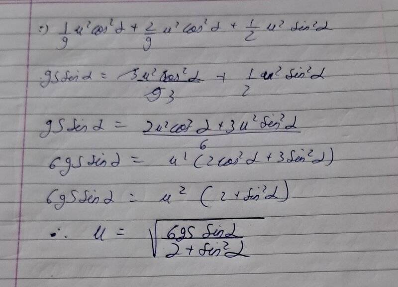

Thanks a lot , i took the top of the triangle as reference line and conserved momentum and i got the required answer . Thanks:)

Could you show us your final work?
