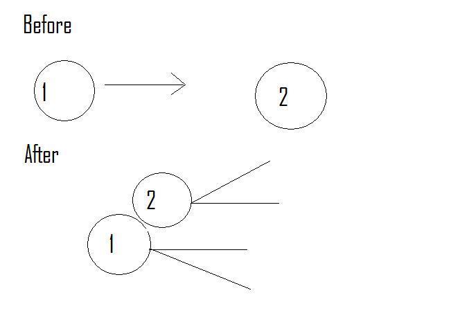

You are playing bocci with your friends. You roll your ball towards your opponent's stationary ball (of equal mass) with a certain speed. After the collision, your ball travels along a path o32 degrees from its original path with a speed of 2.50m/s, while your opponent's ball travels along a path 25 degrees from the original path of your ball. What is the initial velocity of your ball?
Conservation of Momentum.
P1 + P2 = P1' + P2'
Okay, so i tried doing this solution, first i made a diagram of this scenario, but i am not too sure if i drew this correctly. T_T please help me. Here is my attempt of the solution.
So we are trying to find v1
v1 = ?
Pi - initial momentum
Pf - final momentum
Pi = Pf
m1v1 + m2v2 = m1v1' + m2v2'
m1v1 + 0 = m1v1' + m2v2'
... this is far as i have gone, i was not too sure what to place as my v2' ...
and the masses? hm... :(. Please Help! T_T

(can't see your attachment as yet).
If they had collided elastically I could have suggested an easier way to find it (I think)
But what you could do is split the velocities at the angles into vertical and horizontal components and then use conservation of momentum in both the vertical and horizontal directions.
