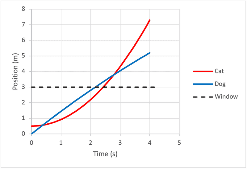

I think that the best approach is, as others have already suggested, to make a plot. The one on the right shows the above possibility with the sleeping cat at 0.5 m from the entrance, the other parameters being the same.
One can also find the minimum safe distance of the cat from the entrance by finding the time at which the two parabolas have equal slopes and substituting that time in one of the position equations.
Sure, but you had already made that point. I was trying, as I generally do, to nail the specific error in the OP's approach.

View attachment 352771I think that the best approach is, as others have already suggested, to make a plot. The one on the right shows the above possibility with the sleeping cat at 0.5 m from the entrance, the other parameters being the same.
FinalIy, cannot resist noting that a passerby below the window might be astonished to observe that it's literally raining cats and dogs.
I like your graphical representation, thank you indeed. The cat actually starts from the middle of the room, which is at position 1.5 meters, but that's a technical detail, your graphs truly depict the opposing signs of accelerations. Thanks again!
Yes, I used a different starting position ##x_0## for the cat to illustrate the catch-up condition graphically relative to the window. Now that I think about I think that the best way to approach this problem is to calculate minimum the "safe distance" ##x_{\text{min}}## of the cat from the entrance and compare with ##x_0##.
This can be done by setting the equations of the animals' parabolas equal to each other. The roots of the resulting quadratic equation will give the times at which the two animals are at the same position. However, there is no need to find these times. We just have to find the discriminant of the equation. There will be two roots if the discriminant is positive, one root if it zero and no roots if it is negative. We are interested in a negative discriminant because that is the threshold for a possible catch-up. Thus, $$\begin{align}
&x_0+ \frac{1}{2}a_ct^2=v_0t-\frac {1}{2}a_d t^2 \nonumber \\
& (a_c+a_d)t^2-2v_0t+2x_0=0 \nonumber \\
& \text{Disc.}=v_0^2-2x_0(a_c+a_d) <0 \implies x_0>\frac{v_0^2}{2(a_c+a_d)}.\nonumber
\end{align}$$ Here, the critical value for ##x_0## above which the cat is guaranteed to escape is $$x_{\text{crit.}}=\frac{(1.5~\text{m/s})^2}{2(0.85+0.1)(\text{m/s}^2)}=1.18~\text{m}.$$
The graph for this problem is shown on the right with the critical value for ##x_0## added.
Note that
  • Since the cat starts above the critical value, it escapes and there is no possibility that it will be caught no matter where the window is.
  • If the cat starts at the critical value, the red line showing its position is tangent to both the green critical line and the blue line for the dog. The cat may or may not be caught depending on where the window is.
  • If the cat starts below the critical value, it may still escape if the window is close enough to it. In the limit that the window is at the cat's starting position, the cat will always escape. Perhaps that is why cats like to sleep on window sills.
