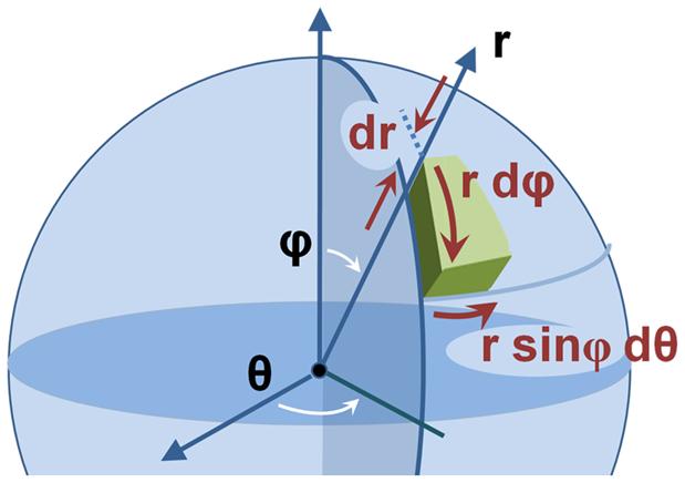

Refering to the above diagram, consider a particle orbiting at constant ##\varphi## in a small circle around the North pole. For a small enough circle, this will approximate a small flat disc.While describing this circle, r and ##\varphi## remain constant. This implies rotational symmetry for a rotation in the ##\theta## direction. Noether's conservation theorem tells us that angular momentum is conserved if there is rotational symmetry. Therefore, (if I have interpreted Noether correctly) the angular momentum of the disc (or ring) at constant altitude should remain constant over time. Due to the spherical symmetry of the Schwarzschild metric this circle at constant r, does not have to be around the North pole.
