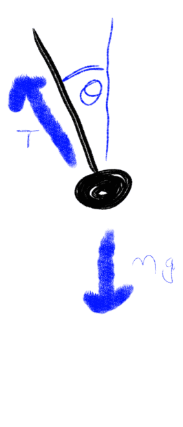

I have a question related to Landau's book. In that, he says:
If we were to choose an arbitrary frame of reference, space would be in- homogeneous and anisotropic. This means that, even if a body interacted with no other bodies, its various positions in space and its different orienta- tions would not be mechanically equivalent. The same would in general be true of time, which would likewise be inhomogeneous; that is, different in- stants would not be equivalent. Such properties of space and time would evidently complicate the description of mechanical phenomena. For example, a free body (i.e. one subject to no external action) could not remain at rest: if its velocity were zero at some instant, it would begin to move in some direc- tion at the next instant.
It is found, however, that a frame of reference can always be chosen in which space is homogeneous and isotropic and time is homogeneous. This is called an inertial frame. In particular, in such a frame a free body which is at rest at some instant remains always at rest.
As an example, I'd like to bring a car and the ball hung inside the car and we can look at it from 2 different frames of reference.
Frame of reference is me(I'm inside the car): If car moves with constant speed, nothing happens to the ball, but if car accelerates, ball starts to swing back or forward(depending on acceleration forward or backward). You could say that in acceleration mode, space inside the car is inhomogeneous, anistropic as ball behaves differently.
When we choose a frame or reference as the person outside the car, to him, wouldn't the ball inside car behave the same way as observed from my reference frame ? It's like things are kind of mixed up in my head and can't put them in order.
Would appreciate the complete, good explanation of Landau's thoughts(I think he is repeating Galillei's relativity, but still) in terms of my example.

The ball is accelerated by the string - that's a real force. If it wasn't attached to something inside the car, then it wouldn't move until something inside the car hit it.
Correct, but the real question is: why didn't we say that from car frame reference that ball was accelerated by the string and there must have been fictitious force?
I think you need to draw a diagram of this scenario with the real forces marked.
If the ball is attached to the car, then in the car frame it is not accelerating. But, there is a measurable real force on it. And, again, Newton's second law is not obeyed: force but not acceleration. So, we add a fictitious force to the ball to cancel out the real force and we have restored Newton's second law: net force is zero and acceleration is zero.

The ball accelerates initially until the string gets a chance to pull it along with the car. That's an irrelevant complication. It just means the real force on the ball acts slightly after the real force on the car.
gionole said:
"If the ball is attached to the car, then in the car frame it is not accelerating", why is that ? If I'm in a car and car accelerated, ball will definitely move to the opposite direction.
If the ball is "attached" to the car we take that to mean the ball doesn't move relative to the car.

In the car frame (assuming uniformly accelerating car) the ball does not accelerate. It hangs at rest at an angle. The tension should make it accelerate horizontally, but it does not. So the fictitious force must be pulling it backwards to prevent it from accelerating.
gionole said:
in inertial frame, acceleration must be explained by the real force, not fictitious. So from this inertial frame, with what "real force" do you explain the ball's movement inside the car ?
In the inertial frame the ball is accelerating horizontally. The real force is the tension acting on the ball.

One problem is that you are not clear about the setup you are proposing. I am assuming for simplicity that the car is accelerating uniformly. You have not stated clearly what acceleration profile you are considering.
In a uniformly accelerating car, in the car's frame, a ball hanging does not accelerate. It simply hangs there at an angle from the vertical. The ball is hanging from a pivot point, that pivot point is attached to the car so it does not move in the car's frame, so the distance to the pivot point does not change and in the case of uniform acceleration the angle does not change either. The effect of the fictitious force is to allow the ball to not accelerate while the tension is pulling it forward.
The rest frame of a non-uniformly accelerating car is MUCH more complicated to analyze. I think you should avoid it for now. I would not participate in that discussion as it is more effort than it is worth.
It seems like something is confusing to me, but I don't know what. If you can bear with me, I will explain how I understand the whole situation.
Car is moving with constant velocity 20m/s and then accelerates in uniform mode.
From ground frame: everything in the car was moving with the same 20m/s velocity and when car accelerated, the following happened: ceiling accelerated instantly, which caused the forward force(the force in the same direction as the car) to act on the upper point on the string, but force transfer through the string is not instantenous and there's a delay because of which the following occurs: the car moves with updated velocity, but ball itself still moves with old velocity(force didn't arrive yet through the end of the string where the ball is attached), so we got a difference in velocities - car moves faster than the ball which ends up in swing mode of the ball backwards. In reality, it's not truly that ball moves backward, it's just our perception, but in reality, it's just car moves faster than ball and thats why swinging perception of the ball occurs. We say this obeys in newton's law, because ball actually continued motion with the old velocity(if no force acted on it, object continues moving in the same speed and it's true due to force delay).
From the car frame: I got a problem here. I sit in a car. I understand that to me, when car moves with constant speed at first, everything is stationary - i look at ball or anything for that matter, and nothing moves. Now acceleration happened, but to me, ceiling is still stationary - to me, car/ceiling still feel like stationary. Now, if to me, if i feel that everything is still stationary, why did the ball swing back ? I think this is the scenario we try to explain and can't explain with the same logic as we did in ground frame. Since ceiling to me didn't accelerate, it couldn't have caused force in the tension the same way as in ground frame, but ball still swang backwards, so if no force acted on it, why did it move backwards ? It seems like newton's law broke - if no force, it should have stayed at rest or moving with the same speed, but the ball accelerated. The way you explain the swing of ball backwards is(i.e it's acceleration - because to me, it's not stationary during its backwards movement), some fictitious force must have happened.
Where would you say I'm wrong ? Would appreciate to point out the exact things that I wrongly said.
Thanks already so much for bearing with me. Physics in terms of intuitivity is lot harder than I imagined.
