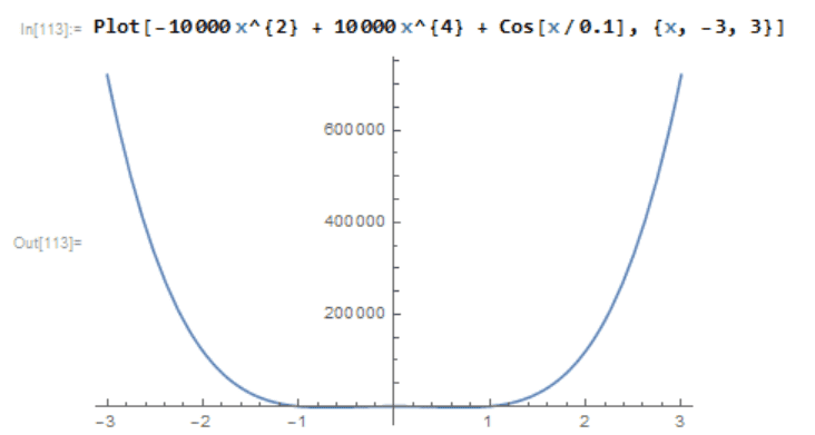

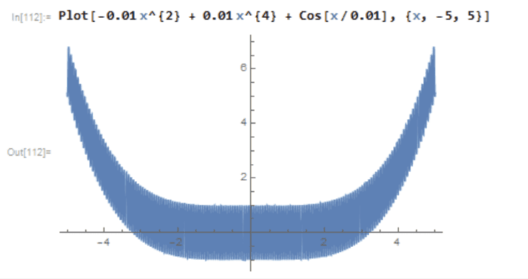

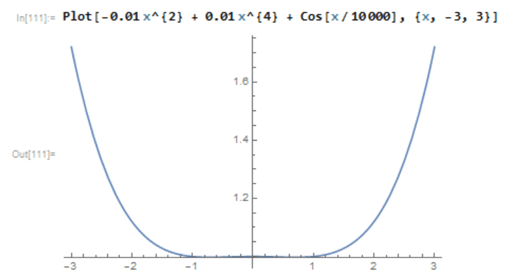

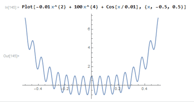

Consider the function
$$f(x) = - \frac{1}{2}a^{2}x^{2} + \frac{1}{4}bx^{4} + d^{4}\cos(x/c),$$
where ##a##, ##b##, ##c## and ##d## are arbitrary parameters.
For some region(s) of the parameter space, there are oscillations in the function. My goal is to identify these regions of the parameter space.
Here are three examples:
Does this mean that there are bumps in the function only for ##c \sim a## (and any arbitrary value of ##b## and ##d##)?
Did you calculate the derivative?
What does it tell you?
