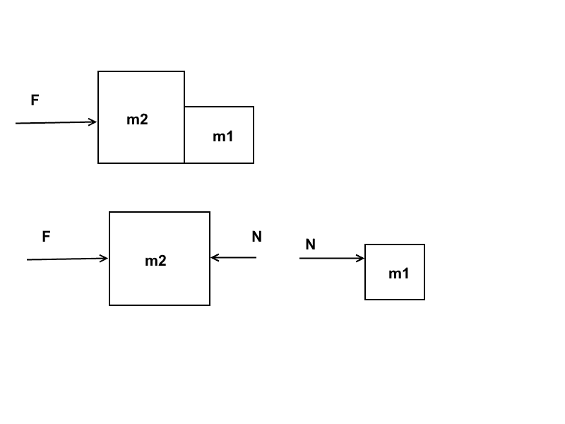

The first part of the problem is the one where I have issues with.
First of all, our teacher wants us to write the forces that act on each block (or rather, the Newton law applied to each block individually). This part right here already drives me crazy. My attempt:
1. For the first body: [Weight] + [Normal force] + [Contact force between m1 and m2] = m1 * a
2. For the second body: [Weight] + [Normal force] + [Contact force between m2 and m1] + [Force F] = m2 * a
The first thing that short-circuits my brain is: when writing the forces that act on each individual body, when we consider the "contact force", which one(s) do we need to actually consider?
I'll post a picture and three possible answers (only one is correct, but I don't know which one):
Q1 (question 1): is the scheme correct, at least? Is there anything missing? (Proportionality/vectors starting in the barycenter of the bodies don't matter)
I called "Action" force the force that m2 exerts on m1, as a result of force F pushing on m2.
I called "Reaction" force the force that m1 exerts back on m1, because of the third law of Newton that says action-reaction and stuff.
Q2: assuming it is correct, what's the proper way of writing the forces for each body individually? The three options (A, B, C) that come to mind are:

Wow! I haven't read all of that but you/teacher seem to be making it way too complicated.
Lets define left as +ve.
Part 1: The problem statement just asks for the contact forces between the two blocks. You can ignore all the vertical forces and just look at the horizontal forces..
Block m1 is accelerating to the left at "a" so there must be a net horizontal force acting on it = m1*a to the left. There is no friction so the force that m2 applies to m1 is just F21 = m1a.
Newton's law says that m1 must apply an equal and opposite reaction force on m2 which is F12 = -m1a.
Those are the only "contact forces between the two blocks".
Part 2: You appear to have this correct.
The problem statement doesn't require that but you could write something like...
Vertically: The vertical forces acting on m1 sum to zero. So applying Newton's law in the vertical direction you get m1a1v=0 so a1v=0. The same applies to block m2 and a2v=0. Neither block is accelerating vertically. No surprise there.
Horizontally:
For block m1 you just have the force f21 = m1a.
For block m2 there are two forces, the applied force F and the reaction force F12 = -m1a. So applying Newtons law...
Net force = mass * acceleration
F + F12 = m2a
F + (-m1a) = m2a
rearrange..
F = m1a + m2a
F = (m1 + m2)a
which is what you expect.
May I suggest a free body diagram that labels all the forces on the blocks? see attached. For clarity, I did not show the contact force between the floor and the blocks, but as a general practice you should. Almost ALL problems require a nice clean sketch showing the forces and which way is positive. Perhaps showing the blocks individually would help?

So, am I to understand that when we write the forces for a body [or make the forces diagrams for each block individually, as advised by the second reply], in a general situation, we only write the forces that act ON the body, but never the forces that the body exerts on other objects? Is this interpretation correct?
Correct. The FBD normally shows just one body and the forces acting on it. Not the forces it puts on other objects.
If there are two objects then draw two separate FBDs.
I'm sure others will have other opinions, But I believe before you start "pushing buttons" on the calculator or writing a bunch of equations, draw a really nice sketch and clearly label all the forces. If there are multiple bodies or parts draw a separate sketch for each body (generally speaking something like the sketch above). Also, be extra careful to neatly write each step of your solution process/algebra. Working neatly will reduce the frustration and perceived complexity of the problem. You don't want to hinder learning and understand by with carelessness and sloppiness. Just a thought. I believe you will find useful.
Not sure how to respond the "last bit". Because there are 2 bodies in contact there is a contact force between them called the "normal" force. Depending on how you say it, the normal force is the force of body "A" on body "B". On the other hand, it is also the force of Body "B" on Body "A". (every action has equal and opposite reaction). Hence in the sketch, it is shown on both bodies. Just to be clear, the normal force is perpendicular to the plane of contact between the bodies.
