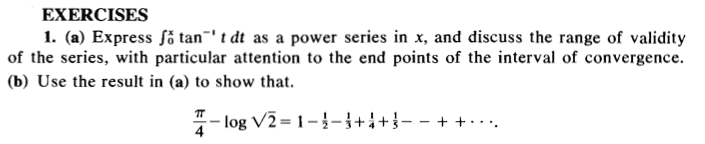

An exercise from advanced calculus by taylor :
(a)
##\int_{0}^{x} tan^{-1}(t) dt = \int_{0}^{x} \sum_{n=0}^{∞} (-1)^n \frac{t^{2n+1}}{2n+1} dt = \sum_{n=0}^{∞} \frac{(-1)^n}{2n+1} \int_{0}^{x} t^{2n+1} dt = \sum_{n=0}^{∞} \frac{(-1)^n}{2n+1} \frac{x^{2n+2}}{2n+2}##
Now I won't plaster everything here, but this series appears to converge for ##|x| < 1## by the ratio test. The question asks me to pay special attention to the endpoints of the interval of convergence, namely ##±1##.
By some quick inspection, I see that at x = 1 the series will converge absolutely by p-comparison so that the series will be uniformly convergent on [0,1] by Abel's theorem.
At x = -1 the series appears to be absolutely convergent by p-comparison so that the series converges uniformly on [-1,0] by Abel's theorem once again.
This implies the series is uniformly convergent over the whole interval [-1,1].
(b)
I have no clue how to do part (b) for some reason though. I know that as ##x→1^-##, ##arctan(x)→π/4##
Not quite sure how to use this though.

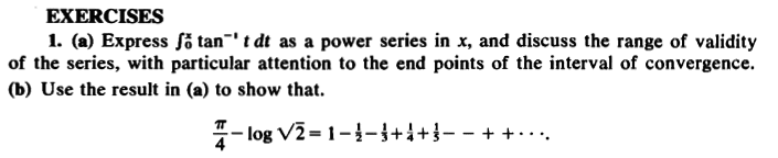

[ url]http://gyazo.com/42bad5b853d34bd2bcf504afa86a1397[/url]
Here's an image of the problem:
Thanks Sammy.
I was thinking a moment ago for part (b).
Consider : ##lim_{x→1^-} \space arctan(x) - ln( \sqrt{x+1}) = lim_{x→1^-} \space arctan(x) - \frac{1}{2}ln(x+1)##
Perhaps that could be of some usage? I could convert each function into its equivalent Taylor series and I'll take a stab in the dark that things will start cancelling out.
^Just a hint, it's not a matter so much of cancelling as it is evaluating arctan(x) and 1/2 ln(x+1) and noticing a pattern. Whatever series you use, be mindful of where they are centered, by which I mean be mindful of your choice of z_0 in \sum_{n=0}^\infty a_n(z-z_0)^n. If the series you're using are not given by your teacher or haven't been derived in class, you might want to state or show the radius of convergence and check endpoints.
That seems like more of a first year thing learning what ln(x+1) is in terms of its series.
##ln(x+1) = \sum_{n=1}^{∞} (-1)^{n+1} \frac{x^n}{n}## which i know will converge for x inside the interval (-1,1].
EDIT : Ohh so as x goes to 1 from the left, the desired result is achieved since the series for ln(x+1) converges for x in (-1,1].
