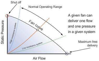

For most types of centrifugal fans and blowers, their performance curve indicates that they can develop more static pressure when the volumetric flow is minimum and vice-verse.
It simply means that the higher the velocity, the greater will be the rise in pressure. Because less volume means less mass and higher velocity.
That statement is not accurate, sorry.
There is no higher velocity of the supplied flow when a blower is increasing discharge pressure the most.
Just like the rpm's of an engine facing a step hill would naturally decrease, when the duct system imposes a greater resistance to the flow (increased inlet-outlet pressure differential), the rate of flow is sacrificed.
