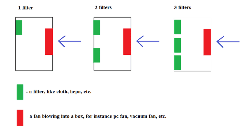

Just a few quick questions regarding airflow, mostly in connection with motors creating the airflow, like pc fans, vacuum motor, air going into a car engine through air filter, etc.
1) Adding more filters increases the availably surface through which the air can flow, therefor reducing the resistance. Am i correct in that ? How would one get the appropriate reduction of the resistance by doubling the filter surface ? I know exact number depends on many aspects but just to get a broad idea, is the resistance halved or is the resistance reduced by a lot smaller amount ?

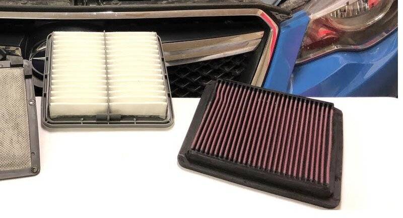

3) Is this the reason why expensive workshop vacuums usualy have a bigger hepa filter (more surface) than cheap ones and why sports air filters usualy have more dense structure than cheap ones (more curves - more actual filter material), in the image below the cheap white has 15 curves while the more expensive one has 28 curves - a lot more actual filter material (path for air to go through) on the expensive filter.

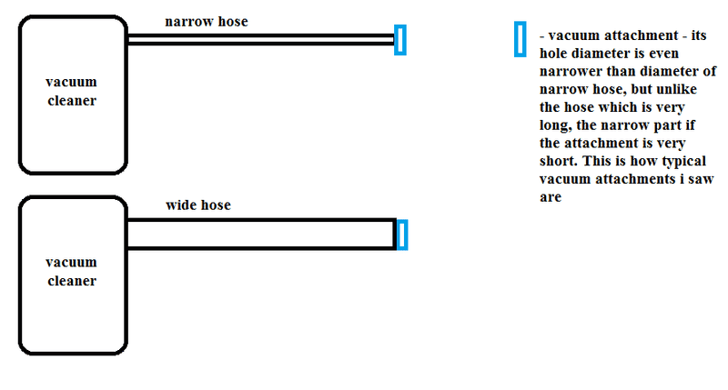

4) Another thing i saw was that many of the more expensive workshop vacuums use wider hoses. That would mean that because they are wider, there is less resistance for air to travel through. And while the actual speed of air might be slower, due to a lot wider hose, the volume of air that travels through it per minute will be higher. Am i correct ?
5) What if we used a wider hose for less air resistance but at the end of that hose, there was a narrowing - an example of that could be a vacuum attachment. Does that mean that even though the hole in the attachment is the same for both cases (see image below), the fact that the hose itself is wider means the resistance would be smaller and airflow greater ?

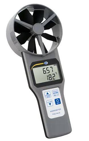

6) Would a wind speed meter be appropriate to compare such scenarios, more air speed means less resistance ? Could i also get aproximation of volume of air moved per minute by taking into account air speed and diameter of the exiting tube ?
Yes. If the flow through the filter is laminar, the resistance will be half at the same flow. If the flow is turbulent, the resistance will be less than half. Search terms to learn about the difference: laminar flow and turbulent flow.
SentinelAeon said:
There was a comparison between just using 1 filter and fan attached directly to it and a Corsi–Rosenthal Box - here you have 4 usable filters. But when they compared the air speed flowing through the fan, it was only improved for about 20%
Any system with air flow through it has a system curve (search the term). The resulting flow is the point where the system curve intersects the fan curve (search that term). Changing the resistance of one part of the system may or may not have a large effect on the total flow.
Hepa filters have more resistance than less effective filters. Also, larger filters hold more particulates. And this is a case where you get what you pay for.
You pay more to get more "suck", or a combination of more air flow and more vacuum. The larger hoses move more material, and larger chunks. The combination of more air flow and more vacuum requires a more powerful motor and larger blower. Again, you get what you pay for.
Probably. The exact answer depends on the size of the hole in the attachment, the diameter of the hose, the length of the hose, and some minor variables.
Yes. This is a good way to measure air flow. Just be aware that the wind speed meter is measuring average velocity over the area of the turbine, and you are measuring a small diameter air flow. If you want compare the total air flow for different hoses and attachments, a good technique is to cut two holes in a sealed box. Insert the hose into one hole, seal around it with duct tape or something, and lay the wind speed meter over the other hole. The wind meter hole might be the same diameter as the wind meter turbine, or it could be larger. If the hole is larger, move the meter around to get an average velocity. Velocity times hole area equals flow.
Measuring air flow are good experiments for a curious person. You can also measure the fan curve by adding a water manometer (search that term) made from a piece of hardware store vinyl tubing and a ruler.
