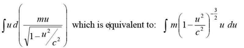

I simply don't understand this conversion. I've only worked with du, dx, dy, etc. before. How do you change a d(γmu) into some kind of du?
(This is in the contest of relativity, although this info is not essential i think)
Thanks! :)
  • Equation: integral of u d( mu over the square root of (1 - u^2/c^2) ) which is equivalent to integral of m(1 - u^2/c^2)^(-3/2) u du.

What is [itex]\displaystyle \frac{d}{du}\left(\frac{mu}{\sqrt{1-u^2/c^2}}\right)\ ?[/itex]

Let [tex]x = \frac{{mu}}{{\sqrt {1 - \frac{{{u^2}}}{{c_{0}^2}}} }}[/tex]
Then solve for u.
Wait dimension10, how do you solve it your way, after getting u = x/sqrt(m^2+x^2/c^2)?
[tex]\begin{array}{l}<br /> {x^2} = \frac{{{m^2}{u^2}}}{{1 - \frac{{{u^2}}}{{{c_0}^2}}}}\\<br /> {x^2} = \frac{{{m^2}}}{{\frac{1}{{{u^2}}} - \frac{1}{{{c_0}^2}}}}\\<br /> \frac{{{m^2}}}{{{x^2}}} + \frac{1}{{c_0^2}} = \frac{1}{{{u^2}}}\\<br /> {u^2} = \frac{1}{{\frac{{{m^2}}}{{{x^2}}} + \frac{1}{{c_0^2}}}}\\<br /> {u^2} = \frac{{c_0^2{x^2}}}{{{m^2}c_0^2 + {x^2}}}\\<br /> u = \frac{{{c_0}x}}{{\sqrt {{m^2}c_0^2 + {x^2}} }}\\<br /> ...\\<br /> \int {\frac{{{c_0}x}}{{\sqrt {{m^2}c_0^2 + {x^2}} }}{\rm{d}}x} = \int {m{{\left( {1 - \frac{{{x^2}}}{{c_0^2}}} \right)}^{ - \frac{3}{2}}}x{\rm{ d}}u} = \int {m{{\left( {1 - \frac{{{u^2}}}{{c_0^2}}} \right)}^{ - \frac{3}{2}}}u{\rm{ d}}u} <br /> \end{array}[/tex]
