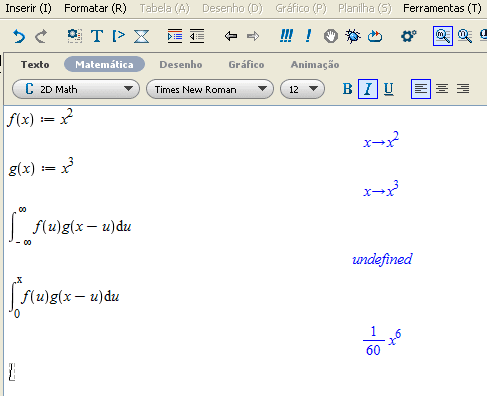

I tryied make the convolution product between x² and x³ by ##\int_{- \infty}^{+ \infty} f(u) g(x-u) du## and the result is an indeterminate form, however, by definition ##\int_{0}^{x} f(u) g(x-u) du##, the result is 1/60 x6. So, [tex]\int_{- \infty}^{+ \infty} f(u) g(x-u) du \overset{?}{=} \frac{1}{60} x^6[/tex] ?

BTW, exist a symmetric algebraic definition for convolution where the graphic of the function f(x) is moved oppositely to g(x) and vice-versa (different of the standard definition, where a function is fixed and the another is moved over the first)? I tryied ##\int_{- \infty}^{+ \infty} f(\frac{1}{2}x+u) g(\frac{1}{2}x-u) du##, but this expression isn't equal to the convolution of f and g...

This equation isn't an affirmation, is a question. In acctually, I'm asking if ##\int_{- \infty}^{+\infty} f(u)g(x−u)du## is equal to ##\int_{0}^{x} f(u)g(x−u)du##.
