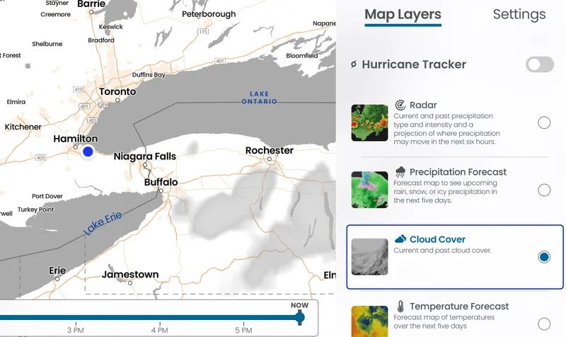

(It's also very weird that the weather map shows zero cloud cover anyhwere within 50 miles. And it is usually accurate up-to-the minute).
